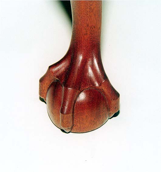

Ed Mulligan, Cape Cod
>Adam -
The shapes you use depend on the size of the foot you're making. Here's my list for a largish chair foot. The 5/25 chisel forms a ball with radius 1 5/16".
5 sweep 20 mm, radiused edge to set in the ball at the back of the foot
5 sweep 25 mm to form the ball
11 sweep 10 mm veiner for the webbing between the toes
25 sweep 10 mm back bent gouge for the toes and tendons
8 mm skew chisel
1 1/4" bench chisel
Ed
Re: carving chisels
Re: carving chisels
>Nice work!
Question: What is the 1-1/4 inch bench chisel used for in this process?
>Thanks, Don -
The bench chisel is used for preliminary shaping of the leg, for preliminary shaping of ball, and anytime you want to take off a lot of material in a flat cut. BTW a small dovetail saw is also useful for rapid removal of waste.
