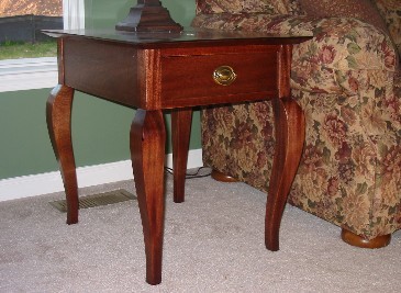

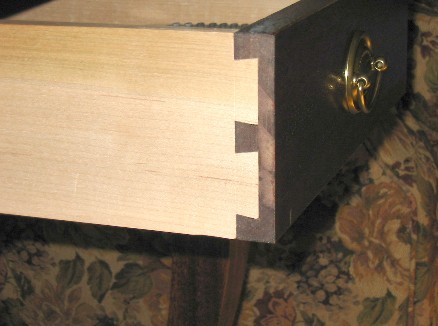

>I finally finished one of the end tables I have been working on for the past few months. This was my first big furniture project since high school. The wood is African mahogany & soft maple for the drawer interior and bottom. I would say 80% of the table was built using only hand tools. I rough cut all of the stock with my Disston #7 and Atkins rip. The 12/4 x 13" stock for the legs was the toughest, for obvious reasons. Joinery is hand chopped/cut mortise and tenon. About 25% of the lumber was surfaced and thicknessed with hand planes and the rest was done with jointer and planer. The leg shapes were also roughed out on the band saw but finished with spokeshaves and sanding. Other than that all of the work was done with hand tools. This was my first experience raising panels by hand (bottom bevel on the table top and drawer bottom) and these were also my first hand cut half blind dovetails. All in all I like the way it turned out. And I loved doing most of it with only hand tools. There is great satisfaction being able to produce something without the use of machines. I still need to work on the finish a bit but other than that it's done. Now to finish the other one. And then.....

>Nice job, Bob. What finish did you use on the table? You achieved a nice colour to the mahogany.
The table looks like it's ready to jump out of the screen at me. The cabriole "dancing/leaping" legs that you've made give the table an active, muscular, appearance. The legs look a bit heavy to me - maybe it's because the transition from the leg to the apron is sharp. Sometimes there's a shoulder between the leg and the apron to soften that transition. But shoulders might make the table too bottom heavy?
On the other hand, when I flip back to your picture a few times, I like the look of the table, but on the other, other hand, it still strikes me as a bit heavy.
In any event, the table looks great. I'm just rambling on because I'm bored at work and semi-sub-consiously trying to avoid doing what I should be doing.
After flipping back to the picture a few more times, maybe it's just the picture's perspective that has me fooled. The rear legs look "right" to me. The front left legs look heavier.

>Steve, the finish is simply two coats of MinWax red mahogany stain followed by a couple of coats of wipe on poly, some light sanding and a couple more coats of regular gloss poly (the wife wanted more gloss than the wipe on was providing). I wanted an oil finish but she didn't like the look of the oil finish (wanted more gloss) and we decided we needed more protection because most of the people that visit us don't know what coasters are - lol! As for the legs, I based their style off of a couple of others I have seen. The picture may make them look a little heavier as you say because it is taken from the corner of the table so the profile looks thicker than it really is. The front legs, however, are identical to the back legs.

>Nice table there is somthing about the proportion of the legs that jumps out at me but don't realy know what. I will print a picture and look at it off and on untill I get a better idea. good work on the drawer. We all need help on finish but from here it looks fine and as I rub my hand over the monitor it feals smooth.

I like the finish. Did you fill the pores?
I too think there is something about the legs. What jumps out at me are the tops of the legs: to me they look too thick and bulge out a bit too much. Maybe if only one of those things were refined a bit more it would look right.
