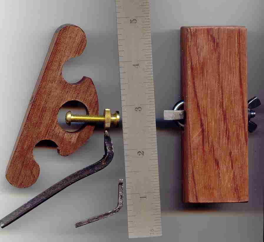

>Looking at adding a Stanley 71 router to my arsenal of wood hacking devices. Gosh, the prices on the bay are wow! Just wondering, I like old tools, but I'm no collector. Anything wrong with the new ones that are available? Also considered just making one based on the routers some of you folks have displayed here. Not exactly a real complicated tool.
Tony
Re: Router PLane
make your own
Dennis
>Easy to make in about any size you want,right now iam making couple small ones but not hard to make one with handles like the stanley.
I also would look for sargent or millerfalls models they sell for less and do the same thing.
Allen wrenchs,concrete nails(my fav) are easy to shape and sharpen. Thumb screws and eye bolts make good holders. For less than $5 can have a nice router that will do the job.

Tim Caley - North Little Rock
>I used a 1/4" Allen wrench when I made mine for the bit. It was posted as a sighting pic a month or so ago.
