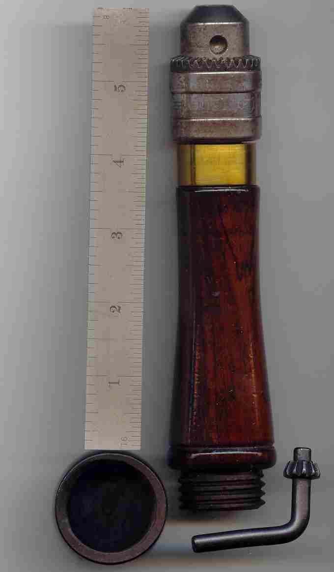

handy tool handle
Dennis
>This was made from old drill chuck and handle off old drill. Works for my Hock burnisher and various other things. I keep the chuck key in the handle.

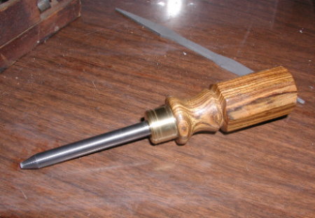

Sandor in Boyds, MD
>I traded some beech wood with Andy for a carbide rod. He needed some to repair the mouths of a couple of woodies.
Here is my finished burnsher. The rod is just press fit into a bocote handle that I turned. The ferrule was made on a metal lathe, also just press fit onto a shoulder.
This burnisher works GREAT. Much better than the only valve stem that I used to use.

Re: Carbide Rod Burnisher
>That looks nice. Being latheless, I shall have do make something simpler. Maybe just a simple octagonal section for the main part of the handle, rasped a bit at both ends to ease the corners. Perhaps a non-turned version of the Sir William plumbing ferrule, if I feel adventurous!
