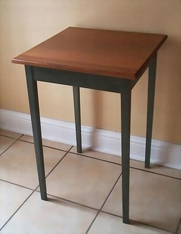

George D. Huron
>Here is an accent table I just completed. The top is quartersawn oak and the base is poplar. The oak is finished with lacquer over a dye stain and the poplar is painted with lexington green milk paint.

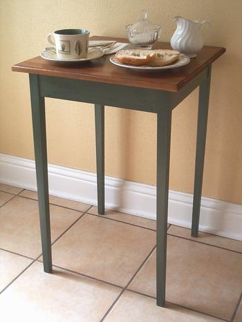

George D. Huron
>Here is an additional view that will appear on my website. Since I am starting a business and being thrifty, I had to eat the props after taking this picture.

Jim Crammond in Monroe, Mi
>George,
Very nice table! I like the proportions and over all design. The contrast between the top and the color of the bottom is very pleasing.
I've just finished a step stool and was thinking of making a first attempt at using milk paint for a finish. What kind of paint do you use and what is your technique?
Thanks,
Jim Crammond

George D. Huron
>The milk paint I use if manufactured by the old fashioned milk paint company. I just follow their instructions and apply about four or five coats (it dries really fast). I then rub with steel wool and use the acrylic finish they manufacture to protect the paint from dirt and water (two coats). I have used BLO and wax before and did not really like the look as much (or the time needed).

Angelo in Cornwall, NY
>Looks great George. I like the way the paint accents the top. I once thought that paint hid the beauty of the wood, but I can see how it brings out the features of the top.
Re: accent table
Re: accent table
George Huron
>I think that, if planned correctly so that the painted wood is pine or poplar, painting is a great finish.
