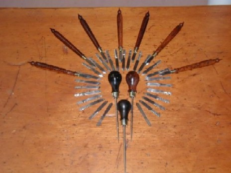

>I have a busy weekend ahead. I have to complete the batch of 31 marking knife blades I've got in process. The blades have been shaped, the rough bevels ground and the blades have been heat treated. I now need to clean them up and sharpen them. Tomorrow I take SWMBO to her sister's to be picked up by the airport limo along with her other siblings for their trip to Ft Lauderdale to visit family, golf, and do the beach routine. Otis the Springer Spaniel and I are bachelors for the week. I have to get together the supplies for doing some painting and other work as a surprise for her when she gets home. If time allows I'll also be working on some other tools. I have to be ready for my toolmaking demo at our guild's April meeting.

I have been eyeing your marking knives - pretty cool. How thick is the tool steel that you are using? I have some 1/8 inch O1 looking for a home. Do you think that it would be too thick?

>The tool steel thickness is up to you. Personally I use 3/32 for the marking knives since the blade sticks out 1 1/2" past the ferrule. I tried 1/16" and found that it was tough to get the right bevel on it though it was plenty stiff enough. Larger and wider blades geneerally should be a bit thicker to maintain stiffness, but the smaller you go the thinner you can go. This naturally nothing but my opinion and is worth exactly the price you paid for it.

>I'm curious about the machinations of your "demo" and thirty one blades. Does everyone in the Guild go home with a completed knife, or with the parts to make one of their own? Do the Guild members participate, making one of their own while you make one, or do they just watch and take home a blade and inspiration? Or do you sell them kits, assuming most of them would not be allowed by SWMBO to temper their own blades in the kitchen.
A couple more questions, while I'm at it (inspired by your SMC snakewood photos). After all the work in the O1 blades, and the expense of the exotic wood of the handles, why do you use thin, spun brass ferrules, instead of turning your own from solid machined brass parts, like the ones I make and those that Dave Jaske makes for sale? I realize the thin ferrules are sufficiently strong, but I like the heft of the solid ones, and that they allow more control of the final shape.
What method do you use for mounting the blade in the turned handle?

>The guild demo is exactly that, a demo rather than a hands on class. Our meetings draw 60-80 people which would be a nightmare for a hands on class. I'll be doing some show and tell on cutting gage making, bowsaws, and on the marking knife. I was going to do a demo of turning a brass hammerhead on a wood lathe, but our meeting site has the lathe tucked away in a dark corner and most folks wouldn't be able to see. I will pick a random member from the audience and guide them through tempering and quenching a marking knife blade blank.
I find the thin brass ferrules to be both plenty strong and attractive enough for trimming out the marking knives. The extra time spent on machining or turning the brass just doen't seem to be well spent to me. I know you differ, but to each his own. The blade shanks are ground down to 1/4" wide and inserted and epoxied into a
1/4" diameter hole drilled into the handle. It's simple, self-centering, and hard to mess up.
I've added a picture so you can see the weekend's work.

>Dave, I didn't mean to sound like I was complaining about the quality of your ferules. It was more of a challenge, to try it a couple of times on your really high end tools. You might be surprised at the difference it makes in their "presentation" for not a lot of additional work, especially after you've gotten used to the process. OTOH, I've used just about every type of hollow metal cylindrical scrap I could lay my hands on for ferrules and striking rings, so I'm not trying to convince anyone that compression nuts are the only "right" answer.
Do you use O1 for the awls, as well? Same source? Preferred diameter? I have to make or buy a couple fists full of awls for some upcoming lofting projects, and the LV ferrules are probably the right answer for those. I still have to decide what wood to use for the handles. It will probably be black locust, because I have lots of that, unless my neighbor's dogwood decides to give up the fight against Anthracnose this summer, and I can save some wood from it. For boatbuilding, the awls take a lot of hard treatment, often beining driven with a hammer, for example to tack a plywood pattern to a beam or plank, or to fix a batten in place to scribe a curve onto a pattern.

>No offense taken at awl. (sorry) I use 3/16" diameter O1 drill rod for the awls and taper grind them to a point on a belt sander, temper them, and then polish up by hand with SiC paper. You might want to consider using a slightly larger diameter if you are going to be pounding them. Also, your compression nut fitting and the Black Locust sounds about right for awls "abused" with a hammer.

>I think 3/16" should work fine, as long as I temper it properly. I found something that migh work even better than the compression nut for awls. It is a cap. Basically the same as a compression nut, but closed on the end. That way, I can drill a hole in the end of the cap that exactly matches the size of the steel.
I sharpened the last awl I made by holding it in the Jacob's chuck in the lathe and using a 4" angle grinder, with an abrasive disc for ferrous metals. Turned them both on at the same time.
