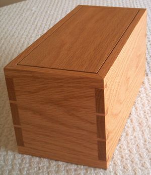

>Here is a photo of a candle box project that will be taught in my school (soon to be open in San Antonio, TX). Note the dovetails mitered at top and bottom to hide the grooves that hold the box lid and bottom. I know that they are hard to see.

>Mitered dovetails are on my "To try" list - any tips on them? I'd take your class, but SA is bit out of the travel budget. ;) If you'd be divulging too many trade secrets, I'd completely understand.

>Scott: Rob Cosman's Advanced Dovetails video has three segments: half-blind; mitered; and, "hounds tooth"...at least I think that is what he called it. Have not had lunch yet so I am in the midst of a senior moment. Just get some stock and go for it.

>Nice design. I like the subtle curve on the lid - sets it apart from all those other sliding-lid box designs.

I'm about to start a small box for a friend -- say about 4" wide by 6" long by 1-2 deep. I like sliding tops.
My question is what is the best way to do the curves? Mark out the profiles on the ends and plane/scrape to the profile. Is there a different way?

>Here are the important tips:
Use a marking gauge and set the gauge to the EXACT thickness of the material before gauging for the dovetails. I create the miter by sawing across the diagonal of the "square" in the corner of each board being sure to stay on the waste side. The square is formed by the gauge line and the edges of the board itself. I stay proud of the diagonal and pare to the diagonal with a bench chisel. With 1/2 inch thick stock I can create the diagonal line with my imagination and so I don't use a guide block. Use very flat stock. Bowed stock will give you fits in both the dovetailing and the mitering.

>I only mark with a pencil and my finger how thick I want the edges of the lid and then how far in from the edges I want to extend the bevel. Then I use a handplane to remove the waste. A scraper is helpful if the grain goes knarly on you.
