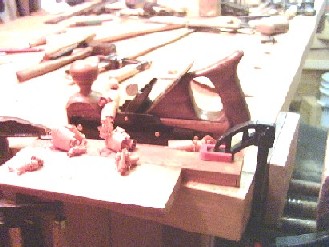

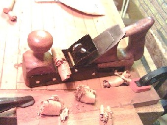

>Here is a picture of the first curlies out of the infill first one were almost full width in mahogany. next I went to White Oak that was a little tougher I think the plane needs more mass. then it was on to maple which were the thinnest and fluffiest. The thumb screw that I got is not what I wanted but it will work untill I get what I do want. I'm happy for now but will start another one with heaver metal maybe even do it the traditional way. I have a small chariot plane started with this metal so I will post pictures of it when it is finished.

>Very nice, bring it to KC when you come, I'd like to see it.

>I broght it last time but it wasn't finished. My wife keeps adding things to my weekends I don't know for sure when I will make it up.

>Ernie that is so nice it encourages me to give it a try. Excellent project going to put it on my list after I make a few of the small scrapers and a large spokeshave.

>If you use channel iorn like me get some that is heavier. This one is to light but it was fairly easy to make and cheep also I might have paid $2 of the plane I stile the blade out of and 70� for the thumb screw.

>If I was to charge myself what I charge my boss and add up all the hours it might be an expensive plane. But then I would have to subtract what a theropest would charge? yah cheap plane.
