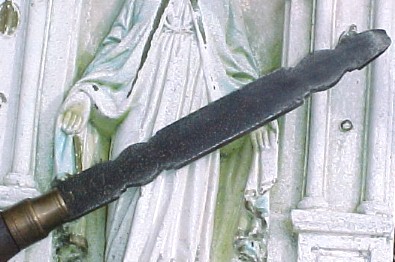

Heres a nice one
Todd Hughes
>I sort of collect these older craftsman made screwdrivers many of them which are made from files.I See allot of them some better then others. This example is one of my favorites, while it doesn't show any file teeth i bet it was made from one.Has some fancy file work and is engraved on both sides with the date 1847.I really like ones with Pewter bolsters but this one has a very well turned brass ferrule and handle and that is OK Too.Was pretty excited when i found it in a box of junk and didn't even try to talk the guy down from $3.....What was I thinking!....Todd

Re: Heres a nice one
Pam Niedermayer - Austin, TX
>Hmmm, nice background. Now if you'd tried a little harder, the apostle could have appeared to be holding the screwdriver.
Pam
Todd Hughes
>Figured the pic. would come out better if taken in natural light,[some reason they tend to come out darker when I down load them here] so took it outside and took the pic. in my cemetary....still didn't turn out to well I don't think....Todd
>Assuming you're using a digital camera, take the cemetary part at a reading that's appropriate, then lay the turnscrew photo on top, add a couple of shadows, and Bob's your uncle. The way it's lit, looks like the tombstone is flat, like a sheet of paper or a photograph.
Pam
