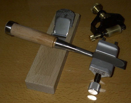

>In a store in Japan I found a honing guide that works quite well, and I think it's pretty much identical to the cheap "Vise-Type Honing Guide" sold by Lee Valley. I have problems with the otherwise excellent Veritas guide slipping on narrow chisels, but it's probably self-inflicted as I didn't fit the rubber pad because I've been mainly using it for plane blades. I'd also recommend water stones, by the way. I'll now attempt to post a piccie, but as this is my first post *ever*, please forgive me if I screw it up...

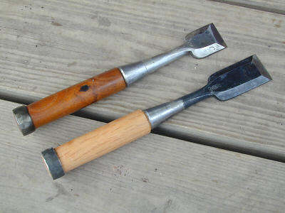

I don't use sandpaper. I know many people who swear by it, so I certainly don't belittle the method, but I'm a waterstone fan myself. I have used waterstones for about the past 25 years. The chisel at left in the photo below will give you an idea of how much sharpening I've done in that time. More recently, I have purchased a couple Shapton waterstones from our sponsor, Japanesetools.com, and I like them even better than my regular waterstones because they cut fast and don't wear as fast.

>I also have problems with the standard Veritas jig on Japanese chisels. Mass produced chisels like the Marples or Stanley have parallel backs and (fronts?). I've never heard of a term for the side opposite from the backs.
Anyways, the Veritas jig uses the "front" as the reference point and has a swivel on the clamp that goes on the back of the blade to put pressure on the front against the jig. But Japanese chisels are usually hand-forged, and getting the front and back parallel is not one of the considerations while forging them. So you do need a vise-type clamp that clamps to the sides of the blade if you are using a jig.
I've found that I use this jig to form a bevel at the desired angle only once, and then free-hand sharpening from that point on. The bevels are so wide on Japanese chisels which makes freehanding them pretty easy.

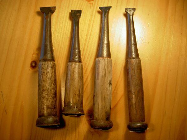

Schwim near Detroit
>Hey Ellis, I recently found this image. Looks like you've got another 25 left in that chisel. LOL (hope this pic uploads, would be anticlimactic if it didn't)

Re: Your chisel is still in diapers
>Impressive signs of use on those chisels.
