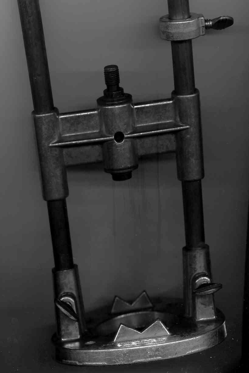

>Bart, (maybe I am being dense here..) what do you mean by a "drill guide?"

Re: Drill Guide *LINK*
Hank Knight
>See Woodcraft link below for "Precision Drill Guide."
Re: Need Bench Ad- Vise
Re: Bad Link
Hank Knight
>Sorry about the bad link. A "Precision Drill Guide" sold by Woodcraft, Highland Hardware and other retailers is a jig used with an electric hand drill that allows one to drill holes at a consistent angle. It has a 3/8" chuck fixed to a collar that slides on two steel rods attached to a base. The chuck has a shaft protruding from the back that you chuck in your electric drill. The whole thing operates a little like a plunge router, except that you use drill bits and the power is supplied by an electric hand drill. Hope this makes sense.
Portalign tool
Dennis
>Picked this one up about month ago at garage sale for 25cents,no idea why but i got it,one of those old tools that are PIA to use, have to take drill chuck off and remount it. I guess it works for some things. The new ones come with chuck so all you have to do is use drill.
Dennis....who has all kinds of strange things follow him home for "just in case"
