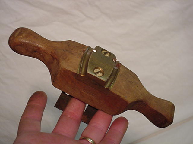

Clay Craig in Miami
>Looks like the radii of the curves in the two channels are too long to spin this in a circle - each channel has a cutter - doesn't seem like it could even ... move.
Auction is linked below the photo, with more pics

Re: What is this? *LINK*
Jim in Burlington Ont.
Re: What is this?
Jim in Burlington Ontario
>Just a guess but I think it's a "one of" to make a bead detail around a gently curved surface. The blades are whole so I think from that fact it wasn't used much.
Re: What is this?
>Looks to me also like it puts a bead on a curved edge, and it has two blades so the wood can be either to the left or right of the cutter.
OK, I see it now ...
Clay Craig in Miami
>Ahhh - so one would use one or the other of those two channels at a time. I was trying to see a way to use both at once ... and not succeeding. Thanks.
Make sense, now that I think about it - if one were cutting a foot-radius bead (or whatever it is) in a full circle, it would be nice to be able to switch the direction of the cut as the grain shifts.
Clay
Re: What is this?
Todd Hughes
>Tools like this are traditionaly associated with Carriage Wagon Builders who were working with curved wood.Not to rare and most , like this example appears to be are Craftsman made.....Todd
