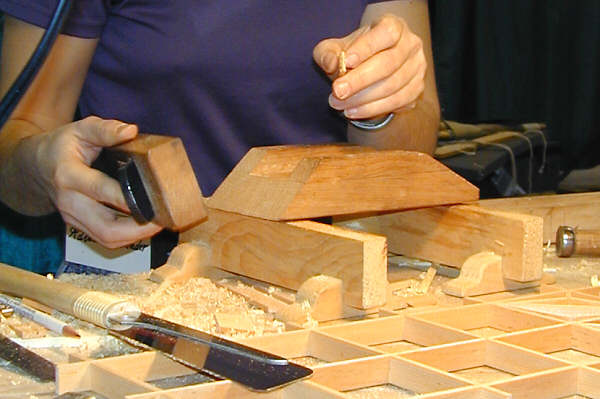

Here's how Toshio does it
>Here is a shot of Toshio's young friend, Laure, working on fitting some very tiny pieces for a shoji screen. Each screen design has different miter angles on different parts of the starburst patterns. For each angle, Toshio has a simple shooting box with the appropriate angle cut on the end. One box can have two different angles. They cut the pieces by eye and then plane the miters perfect with the block plane shown here.
Perfect results, no thankless measuring of lengths and angles.
