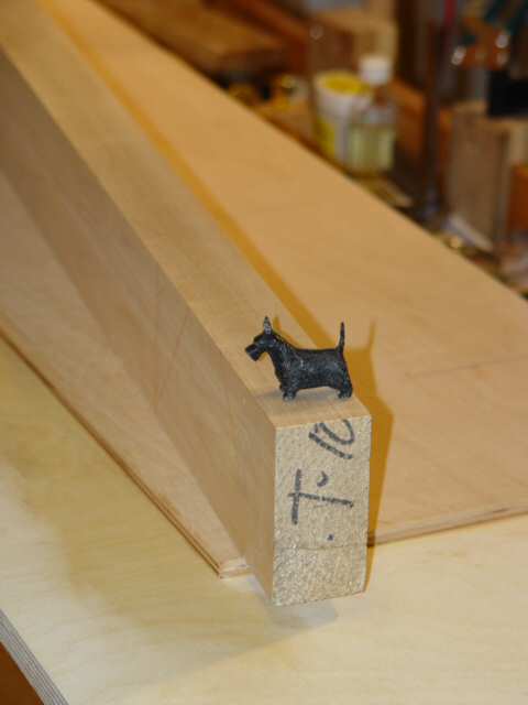

>...for jointing wide boards.
The base (more next posting) is 18mm laminate - fairly stiff - 1800mm long
The top is 8mm ply - 1400mm long
It was important to me to have an overhang at either end. The shooting boards I have used in the past are too short and this makes it difficult to control the plane when jointing.
I could have chosen the grain orientation better... but that was the way the cookie crumbled.
I confess to using my FESTOOL router with the FESTOOL guide rail to make the reference edge.

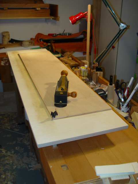

This is the shooting board from the top...

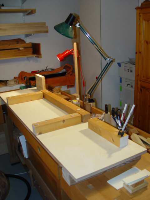

>This is the shooting board from the bottom.
I used 'any old scrap' I found in the stap bin.
I placed cork 'feet' under the base to avoid scoring my workbench.

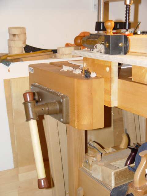

>The shooting board is held in place securely on the workbench.
Here on the right...

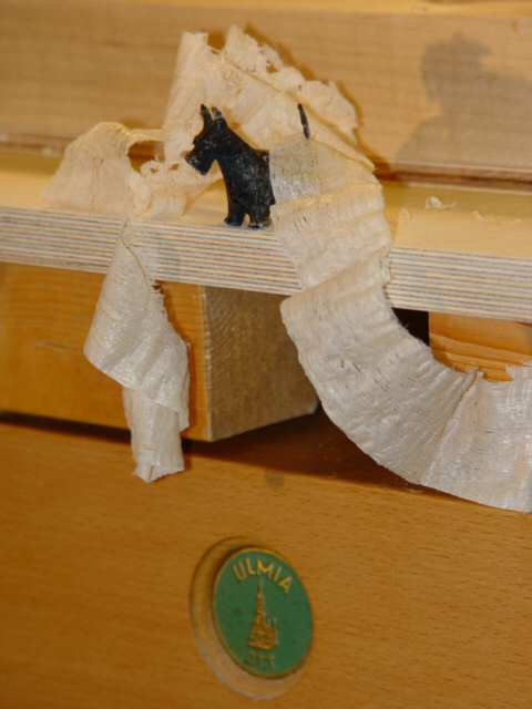

>Jounting 50mm maple like this is sweet.
Re: I made a shooting board...
Re: I made a shooting board... #6
CONGER - The Irish diaspora in Munich

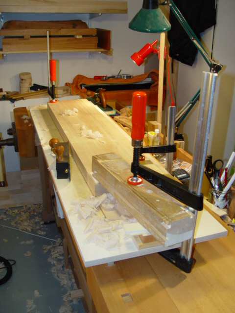

>This is the shooting board in action (50mm maple).
I have not been able to implement the 'embedded' clamp slots at the rear of the board yet... hence securing the workpiece is still a little primitive... but it works well.

>My bench dog has fun withe the wispy shavings.

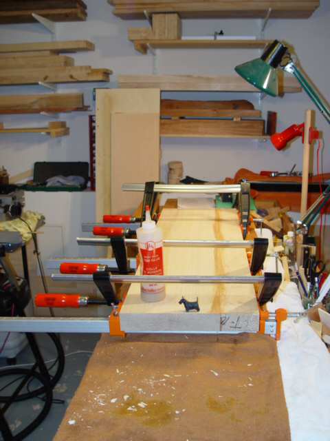

>The jointed maple is glued up with Rob Lees (Lee Valley) excellent fish glue... somewhat sloppy (my 'workmate' was generous with the glue) and also somewhat overclamped... as the joints are almost 'gas tight'! Please excuse the provisional bench covering... I am in pursuit of an alternative (linoleum??).

>Conger,
Looks like a simple yet effective shooting board. Good show!

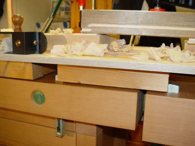

What prevents your plane from cutting into the 8mm reference line board?
Love your Yorkie bench dog.
Todd O.
>Hi Todd (O'Callaghan?),
The 8mm ply is jjjust so that the LN #9 blade covers it by 1mm - i.e. takes off the top veneer. That is not a problem as the board and the plane go together... and so the 're-usability' is covered.
>Hi Todd (O'Callaghan??),
The 8mm ply is 1mm higher than the lowest point of the LN IM plane. That means that the plane cuts the top veneer of the ply.. which is ok.
The plane and the shooting board belong together... so the repeatability of 'shooting' is guaranteed.
