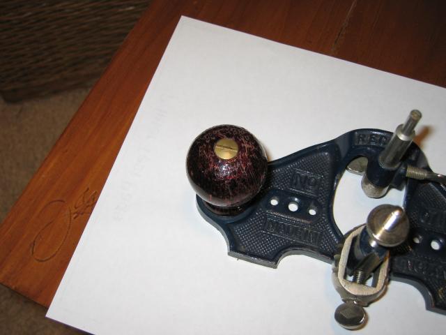

>Hey all I picked up a nice Record 071 recently and everything is good...except for the finish on handles. It's crumbling off and I was wondering what steps I would need to follow to refinish them.
Attached is an image of one of the handles.

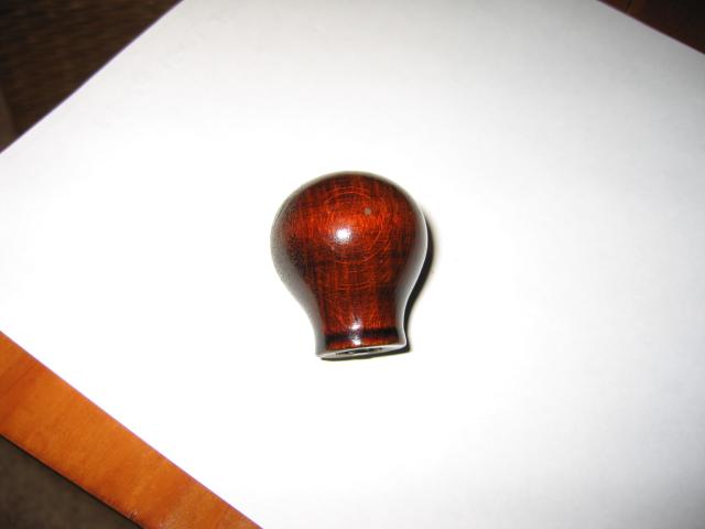

Also, the handle for my record 405 needs some work as well. It's no where near as bad but it does need some work. Images of that handle will follow as responses.
Suggestions?

>The good side of the Record 405 handle...

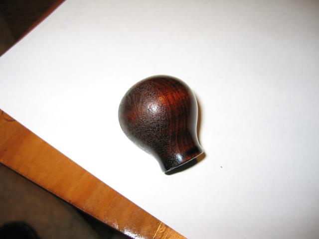

>The bad side...

>You call those BAD?
If ya' must, just use any stripper of your choice to get the existing finish off, sandpaper the raised grain, restain the beech, and apply a new finish. If you're after a nice "touch" use multiple coats of oil or wipe on varnish, or if you want it mirror shiny (and sweaty to use IMHO), use shellac.
But (to re-emphasise) I would consider your handles to be good enough already.
And the rest of your router is in wondrous condition. How are you planning to sharpen the cutters? ;-)
I assume you'll want them as perfect as your refinished handles...!

Simply use lacquer tinner and 0000 steel wool, which works very fast. Wiping down with oil will re-color the wood which will loose some stain in the process. I've never restained handles.
Mike

>... how the finish literally crumbles off the router handles. After taking that pic, I had to brush off the table it was sitting on, since it was covered in little crunchy red particles. It almost looked like I broke some glass and then ground it up or like I took a piece of hard candy and smashed it a few times while it was still wrapped and then opened it up.
Tonight I'll put down a piece of paper, and then just pick it up a few times. Then I'll sweep all the particles into a little pile so it will be easier to see in another picture.
At the rate it is coming off, there will be little finish left on the handles after some minimal use. On a side note, the router is in great shape, except for the handles which seems kind of strange.
As to the 405 handle, yes it looks good on one side but the bad side feels well, bad. I grab it and it feels like sandpaper. It looks like the handle had something spilled on it or was left in water I would guess.
I'd guess ultraviolet (AKA sunlight) damage. Hence the localised effect.

>If it crumbles off that easly I would just use them for awile untill it whears off then give it a coat of BLO It seems to make tools feal better in your hand. some day they will have a nice patina.

>I use regular pot-cleaning pads of steel wool -- SOS or Brillo for plane cleaning. Generally works quite well on loose finishes. Wash, wipe, dry; put on an oil finish or long-oil varnish (I'm fond of Watco because I have some and it dries faster than BLO, in my experience).
Just because you're using a kitchen tool, don't think you can necessarily get away with doing this in the kitchen sink, by the way, unless you live alone or have a tolerant LOYL. This is why God invented laundry tubs and garage cleanup sinks.

>Light was the thing I thought of first when I saw your picture.
On another note:I have an old plane with a broken rosewood tote. I cleaned the break and epoxied the handle. When it dried the finish looked nasty so I sanded it with 180 then 220 grit paper by hand.Just enough to get the surface finish off and remove the scratches. I cleaned the dust off and waxed it. It looks perfect. Nice finish.---Jack

>AFAIK all finishes are damaged by UV, in sufficient quantity.
But oil finishes can't really crack or flake, and wax finishes can trivially removed/renewed.
So the damage is less obvious or important. In any case, I prefer holding wood to holding a finish.

>Lacquer on Record handles I think. I've had more than a few handles that have got damp and the finish has been cracking off. I just ping off the rest with the edge of a sraper, sand and refinish as desired. With the stained beech handles they always seem to look better re-stained and then a coat or two of shellac. An advantage of this I know see is that it makes your tools safe from BugBear... ;~)
