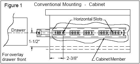

Don't worry about the wood movement. The drawer slides should have at least one horizontal slot which will allow the wood to move parallel to the slide. Your sidewalls will have the grain running up and down, so the shrinkage you care about is in and out of the case: parallel to the slide.

P.S. The other poster is right about the slides always having a horizontal screw hole at one end.
