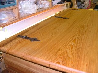

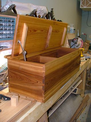

Kurt Loup
>Below is a picture of a blanket chest I am building. It's made from cypress salvaged from an old sugar mill. The finish is Tried and True linseed oil and wax. There's no comparison between old growth/sinker cypress and common lumber yard cypress as far as color goes. I use both though. If you want the name of a couple sources for the older stuff in the Baton Rouge area, send me an email.
Kurt
Re: Working with cypress wood
>That is a great looking chest. I presume that it has a piano hinge? Is that a lift-out tray inside?

hinges
Kurt Loup, Baton Rouge
>Don,
The picture below shows the Lee Valley hinges that I am using. I am building the chest from a picture in a book that surveys early Louisiana furniture, so I am trying to keep the exterior look close to the book. The hinges in the book are not visible, but I thought these would look close enough. The chest is 46" wide and I was worried about the sides bowing, so I added the divider. There are no drawers. I'm not sure how this will hold up, but I laminated cedar closet lining to 3/4" plywood as the bottom. The bottom floats on top of cleats screwed to the sides. The divider prevents the bottom from falling out through the chest. If there is a problem, I can remove the cleats and the ply. Currently, I am working on the lower section of the chest. The top section sits on a matching bottom section with two drawers.

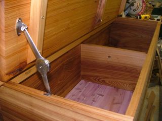

interior
>Here's a picture of the interior. The lid stay is from Rockler. It's not quite strong enough to keep the lid from slamming shut once it gets past 45*. I'll need to order another for the other side.
Kurt

Re: interior
>Thanks for the additional shots. I couldn't see all of the details with the original. Now I see how it goes together.
