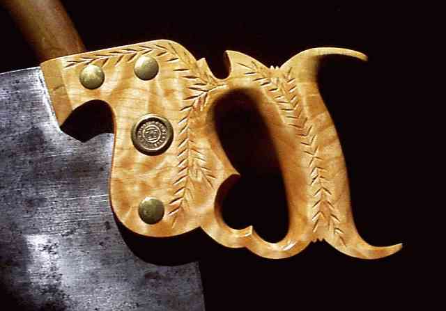

Larry Felix
>Making handles can be rewarding, especially for for Disston 12 saws. Here's one I made to rescue an otherwise good blade. If anyone is interested, I'll be glad to send the drawing I used to make the handle.

Send it to me too, please

VERY Nice
Todd Hughes
>Really a very nice handle !, have to say often when I see a homemade handle it's so ugly you would, as my grandmother would say, have to hang a bone around it to get a dog to play with it but this handle is just beautiful.Really like how you followed the lines of the original.Someday somebody is going to insist that Disston made curly maple handles for no. 12 saws!....Nice work....Todd

Me too please
Tony - Memphis
>Wow, that is really nice!

Re: I'd love
MikeL in SoCal
>You should be able to just save the picture directly from WC. On most systems, click on the picture with your right mouse button and then left click on "save image". HTH.
Cheers,
Mike - who is also very impressed with the handle

Tim Caley - Little Rock
>You should consider submiting that as a shop shot or article so everyone could have access to the drawing.

Larry Felix
>Tim: Good idea. I had no idea that there would be this level of interest. I'll see about posting the drawing, as a minimum. I'll also try to add some notes on avoiding problems and finishing handles, based on this thread.

Paul Brandley
>That's a beautiful handle! I'd like a copy, when you have time...Thanks.

Wow! The TSOA!
Roger Nixon
>That's the Todd Seal of Approval! Better print this one and frame it, Larry :). I completly agree. The combination of #12 lines and pretty maple work great.
