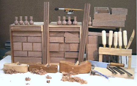

Bill Tindall, E. TN
>I have been working on these 3/4 scale spice boxes (jewelry containers) for some time. I now have the drawers all done and finished. they are "phony" half blinds made by glueing some nice resawed quartered curly walnut onto the fronts of through dovetails (33 total drawers). For these dinky drawers the cheap Zona saw worked much better than LN saw. The carving knife was handy for the dovetail clean-up. Marking done with Pilot gel pen or LV gauge. Home made chisles described previously.
The planes are a conventional block (45 degrees), low angle block (35 degrees) and a 50 degree smoother with an exceptionally annoying shape that I need to correct someday.
The top molding is a modified chair rail. I don't like top moldings that stick out from a piece excessively, which is a problem in this case as it has to be 1 3/8 tall to hide secret top drawer. I haven't figured out the bottom molding yet. I know good shape when I see it but am challenged to design a proper shape.
The mop-like brush was good for shellacing inside of drawers. More on finishing in a later post.
The bench top is not as white as it looks. It is off-white masonite and resulted in a 25% improvement in light intensity over my former brown masonite top. I now have a near optimum 200 foot candles on bench.

>I'm interested in what you think the difference is in the time required to make 3 versus just one. This would be particularly interesting if all of the work had or has been done with hand tools. We all know that using power tools for multiples can cut times by as much as 50-75% since most time is in the setup, but I've never done multiples of a hand tool project all at the same time- hence the question.

answers to above questions
Bill Tindall, E. TN
>Multiples- I never thought of the point you raise. Since I am doing the design there is economy of scale in the decisions of how big, what shape, etc. It took a while to get the bun foot shape right, but it was then quick to make them.
The drawers just took forever and having to do many actually slowed things down due to boredom factor. I just find doing dovetails tedious. I guess if I was working off already made plans and knew already how to do what is needed to do that there would be little economy of scale- 3 vs 1. But, I have 2 daughters and a wife, so three was the required number, however long it finally takes. I still face learning to make a tombstone door to frame a nice piece of crotch walnut I have been saving for this special occasion.
Pilot pens- I too am having a dry out problem after storeage. I thought I had it solved but the pen that was working fine is not now. If I find a fix I will post. Yes, those are the home- made chisels, including some on the base of the holder yet to be handled.
