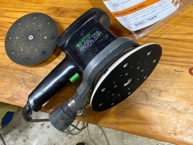

Ellis, I have probably the oldest-in-use Festool sander, which is badged Festo, the 6” E2TE, a forerunner of the popular ETS 150 Festool model. It dates to around 1995.
Since the model is long gone, finding replacement pads took me to Amazon. There are a number of replacements available, and cheapish. While I do not use the sander with anything remotely like a typical user, the pads have been great. I have two, one hard and another soft. It is worth a look.

I have two ETS150s, with 3mm and 5mm orbits, and they take the same pads as your E2TE, with the single screw through the center. The pad for the Rotex, however, has a bayonet-style mount, so it's a different part number. I see your sander was from the days when they were still Festo. I had several from that era too. Kinda dates us...
