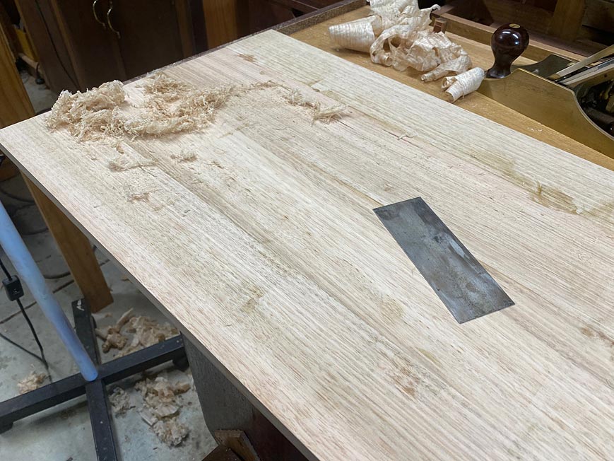

Two panels glued up. Here, removing the squeeze out with a cabinet scraper ...

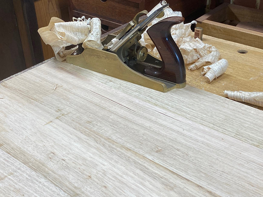

The Oak is quartersawn and the grain has rowed sections. This is alternating hard and soft striations, and tears out with the scraper. Smoothing the four-board panels with a LN #4 1/2 (the bronze Anniversary model), and closed up chipbreaker, leaves the surface smooth and clear ...

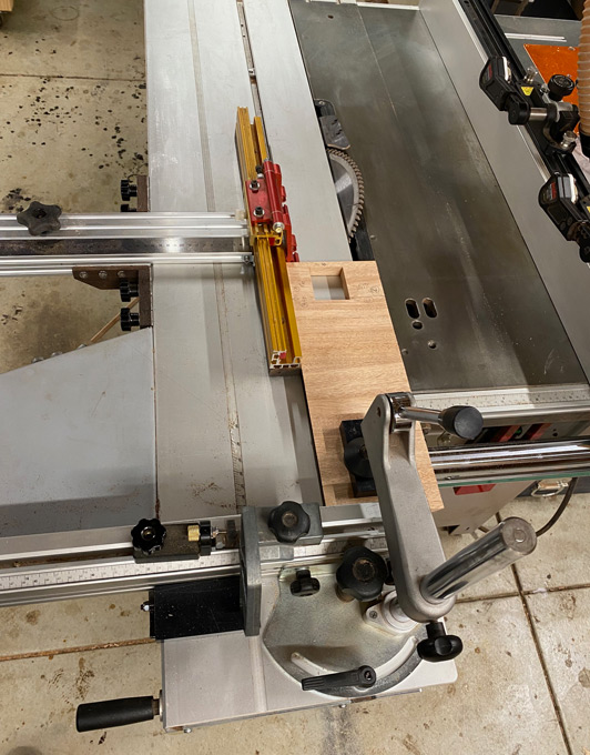

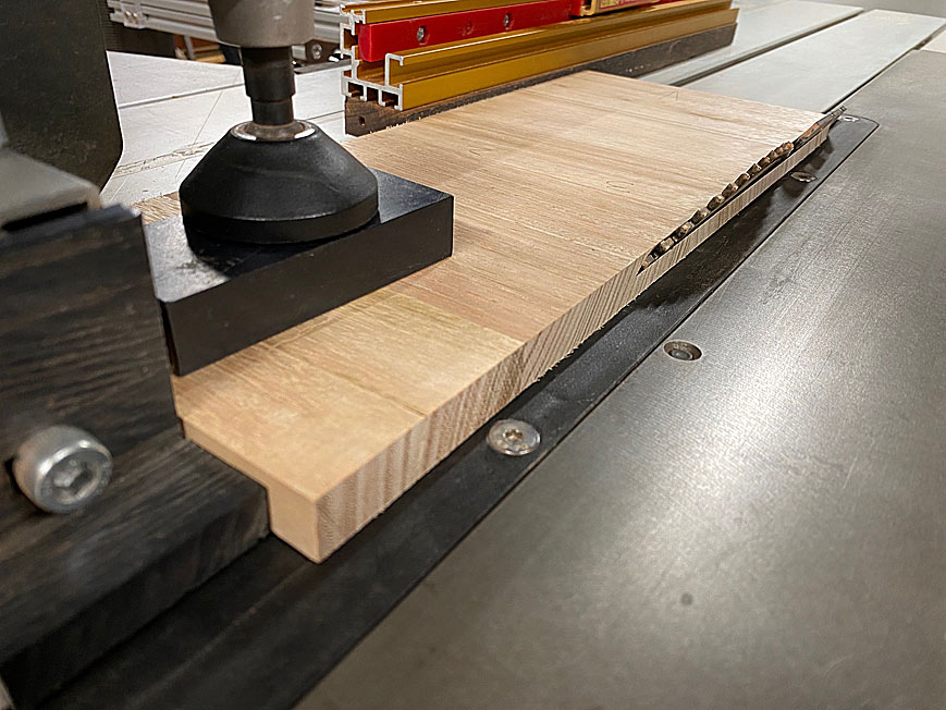

The mitres are cut on a sliding tablesaw, a Hammer K3. Here a side is being mitred, held on on side by a parallel guide I built. This essentially is a fence, like a rip fence, but the work piece is held stationary while it is moved past the blade ...
Once this is dialled in, all one has to do is flip the board for a perfect, parallel mitre on the opposite side.

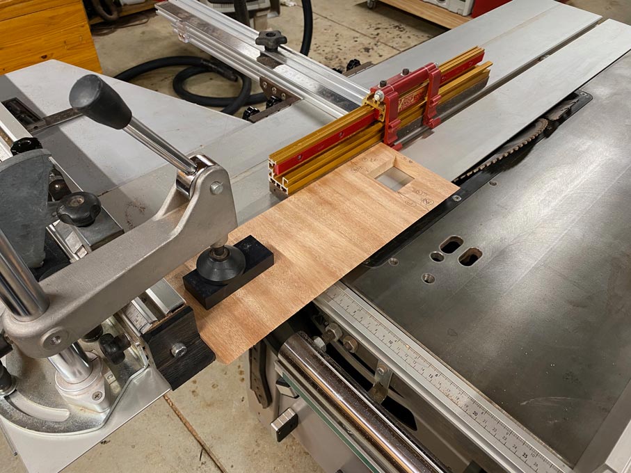

What is seen here is one of the sides with the opening for a little "window" drawer.

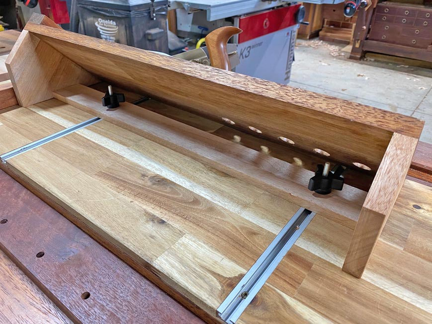

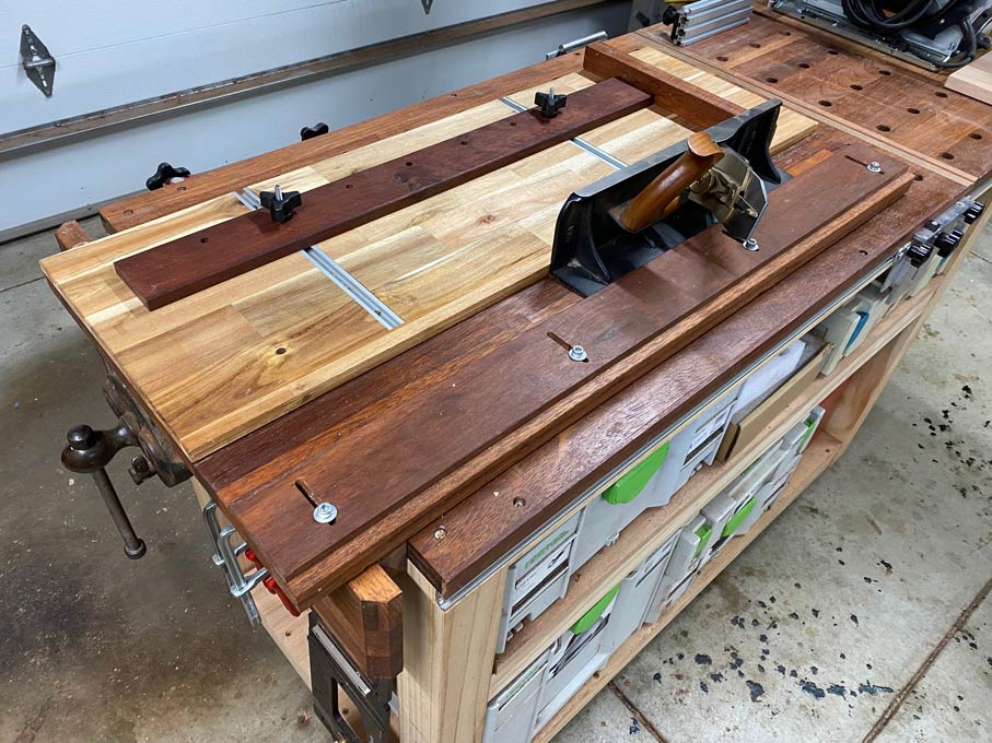

Linked to this, a few years ago I built a large ... giant! ... shooting board designed for jointing panels ...

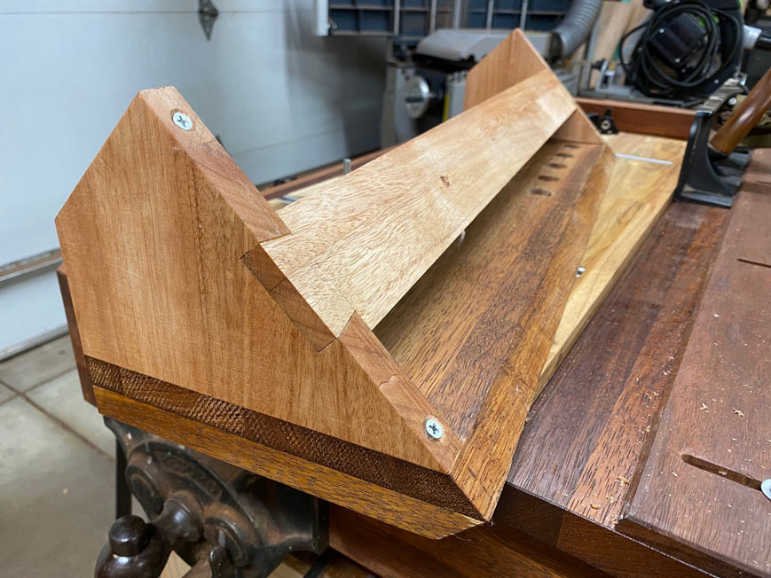

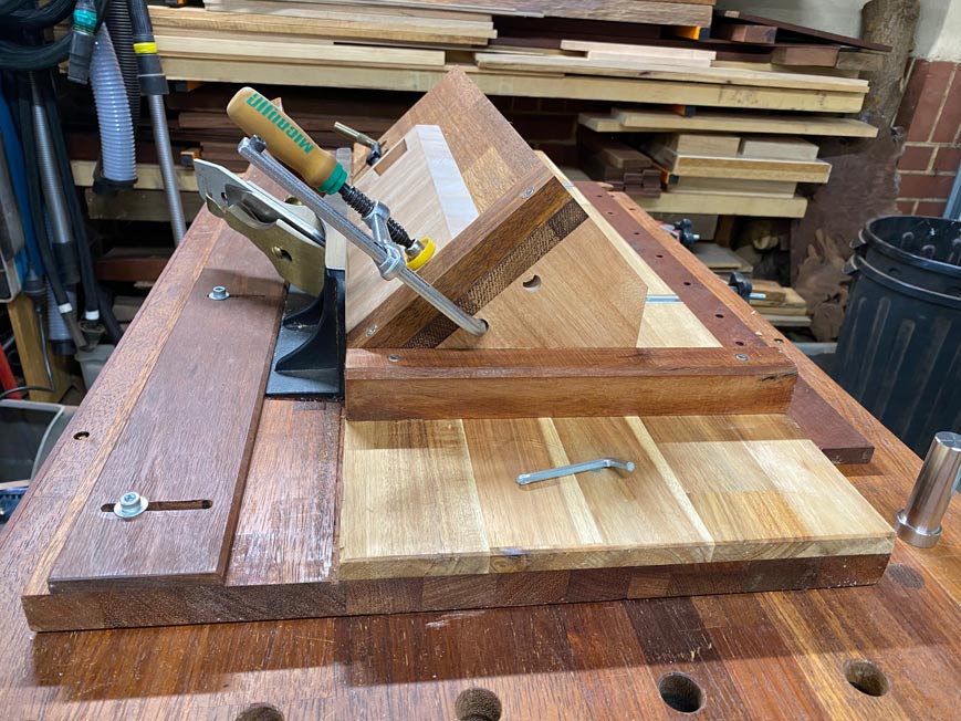

This has now been converted into a giant mitre shooting board ...
This is clamped down from the inside using the mitre tracks ...
The underside, for those interested in the construction. The screws in the base are adjustable legs ...
After sawing the mitres, the shooting board is used to ensure that these are perfectly straight for the cleanest possible joint ..

Technically, this is a mitre shooting board. A Donkey's Ear is different ...
While they appear to do the same thing, the mitre shooting board registers the outside of the board, while the donkey's ear registers the inside of the board. Both have their place.
