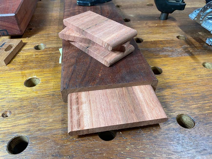

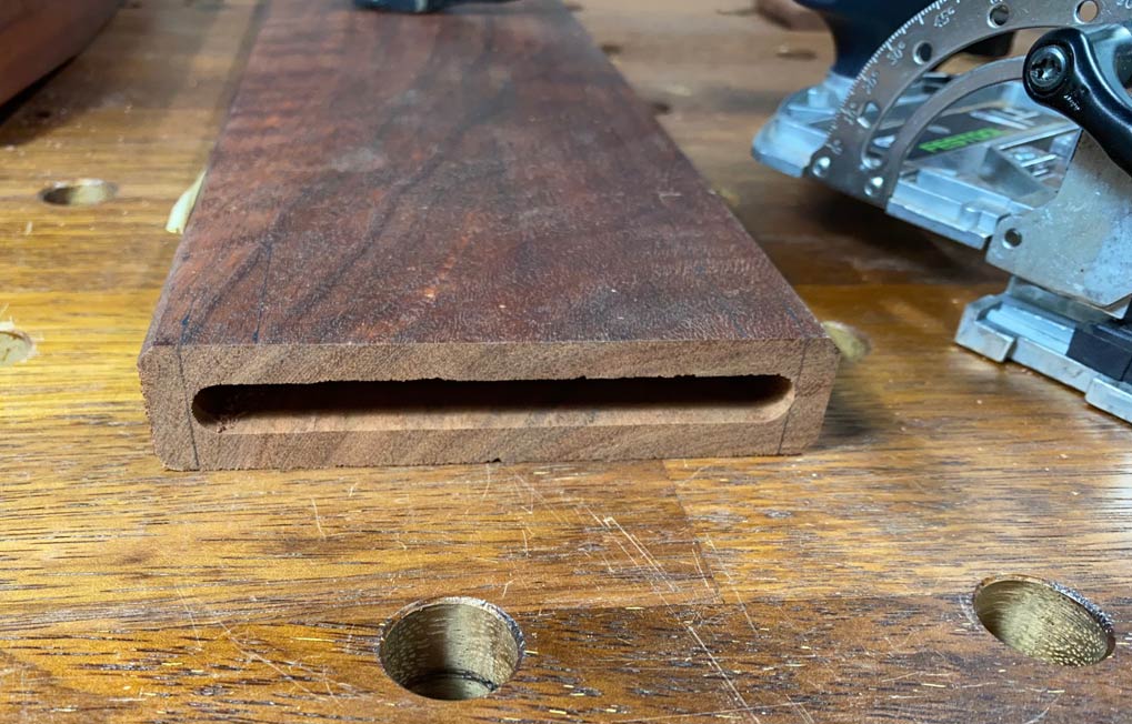

The fit should be firm, with the faces tight …
The above were made with a Domino machine, but the usual way is to use a router.
Of course, you can always use traditional tenons as well. Just allow for the extra length.
The other option is that you can either leave the ends round, or square them. Here I am using a hollow chisel …
