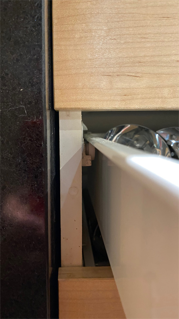

I am in the process of replacing all the cabinet door hinges and drawer slides with soft closing fittings in the kitchen and bathrooms. The door hinges are not a problem, and I am already well on my way there. It is the drawers that I am not sure about.

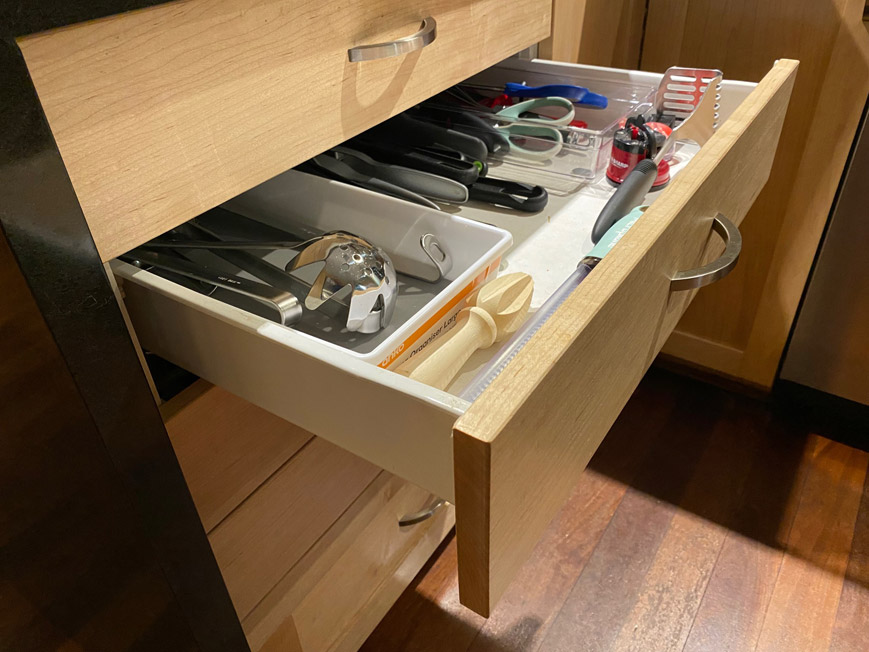

The kitchen was originally built (by a specialist company we employed) 30 years ago. Six years ago I re-furbished the kitchen by replacing all the doors and drawer fronts (in Curly Hard Maple, for those interested). The drawers in the kitchen and bathrooms have wooden fronts, but the internals are metal ...
And run on slides ..
The drawer sides are 500mm long (19 1/2").
The metal drawers now create a slight problem. Runners designed for wooden drawer sides are not suitable.
The question I have is whether I can replace the runners for all the drawers with soft closing ones, or whether I need to keep these and add on a soft closing accessory?
 I have searched but not yet found soft closing runners to replace these. I am not sure they even exist.
The alternative is to add an adapter, made by Titus:  https://www.amazon.com.au/SoftClose-Drawers-Retrofit-measuring-required/dp/B00PE3MBWS/ref=asc_df_B00PE3MBWS/?tag=googleshopdsk-22&linkCode=df0&hvadid=463569826528&hvpos=&hvnetw=g&hvrand=2855350644001396241&hvpone=&hvptwo=&hvqmt=&hvdev=c&hvdvcmdl=&hvlocint=&hvlocphy=9070599&hvtargid=pla-350710822938&psc=1
The advantage of using the adapter is money saved. Good runners are not cheap. Fortunately, there are only 10 drawers to change out. Which means that runners are not going to cost the Earth ... if they can be found!
Any thoughts where you can find runners with soft closing for metal drawers?

Are you sure you can't retrofit Blum slides somehow?
Re: A question about soft closers for drawers
I see three possibilities....
If the space between the drawer side and cabinet is 1/2" or more you could use side mount runners.  Might have to install a wooden spacer if the space is over half and inch.  The screws might be a problem but not insurmountable.
With enough cyphering you might be able to install Blum under mount runners.  Getting them to work and line up with the existing fronts seems challenging.
And last but not least, you could rebuild the drawers and make them out of some fine hardwood the way they are supposed to be.  Use undermount runners and reattach the existing fronts.

I'm thinking that you could retrofit each drawer with some kind of wooden base, or runners, that would properly engage Blum Tandem soft-close slides, provided there's enough headroom under each drawer. Based on your photos, I'm not sure that will work out for you, but it would be worth investigating. In my current kitchen, there is 1 1/8" between the underside of the drawer bottom and the face frame below. You need only about 3/16" side clearance on each side of the drawer to the case sides. The slides I've used have a case member and a drawer member for each side of the drawer. I can't engineer this for you, but it wouldn't hurt to buy yourself a pair of slides and see what you need to do to retrofit them to your metal drawers. Or, as others suggest, just make some simple wooden drawer boxes and use the slides normally.
Here's what the drawer gadget looks like.
... and the back of the drawer looks like this. The kerf is to engage pins in the left and right slide mechanisms that hold the drawer down at the back.
My thought was that if you had enough clearance under the drawer bottom (again, needs to be verified in your case), you'd only need some way to attach this piece to the underside front of the drawer, and drill two holes in the back of the drawer.
I'm a firm believer in lemonade, but nice wooden drawers don't seem too much of a stretch if the job is worth the extra effort.

I do not wish to make new drawers. The drawers are actually great, and just need a soft closing mechanism. My first choice would be to replace the existing slide, but if I cannot, then I will just add these to the existing slides ...
These fittings are quite inexpensive in comparison with new sliders. They are designed to be used with the drawers I have.
Any thoughts?

The one you mentioned shows as being unavailable
but it seems the ones designed for wooden drawers
https://www.amazon.com/Rok-Hardware-Drawers-Adapter-Retrofit/dp/B00JJYIVHM
also might work.
They appear to need 1/2" clearance between the sides of the cabinet and drawer for the two parts to engage properly. Because your metal drawers have a lip at the top, that may require shimming the part that mounts on the cabinet.
As for the part that mounts on the drawer with screws, I would use this instead of drilling into the drawer
https://www.amazon.com/HitLights-Heavy-Double-Sided-Mounting/dp/B00PKI7IBG
and then perhaps putty in the holes with something white for a more finished appearance.
Amazon is showing me a price of only $15.52 for 2 ea, so it may be worth experimenting with something available now. And if they didn't work, there are probably other drawers around the house where they would work just fine.

Peter, thanks for trying. The ones you link to - for wooden sides - will not work with metal-sided drawers. Happily, I live in Australia, and the slides I want are freely available there. I have purchased them already.

Thanks Keith. I looked at your link. Those slides are for wooden-sided drawers. I have found converters for my metal-sided drawers. They should do the job. If they do not, I am not out of pocket much, and then I will look at replacing the slides altogether. Somehow .... replacing the slides was my first choice, but I could not find slides for metal sided drawers.

Derek, I’m not sure there would be any difference for wood or metal other than the screws would need machine threads. And since those epoxy slides are also euro type, the holes would be on the standard 32mm system, and very likely to match the holes as those in my link.
If the cost is an issue, I think KV and others do a knockoff of this slide at a much lower price,
Re: One more thing
Thanks again Keith. The add-on soft closers for the metal drawers do attach differently to usual slides. The metal is only at the sides, and the underside is wood. The add-ons attach underneath the drawer, so there is no need to drill the metal sides.
The cost is not the issue, although I appreciate that the add-on kit is only $12 per drawer. If they. do not work smoothly, then I shall redo the drawers. Our aim is to update the drawers in advance of selling the house in a couple of years. No doubt future owners will have there own ideas on what they like in a kitchen. I like what I built, in curly hard maple. I retained the shells, and added new doors and drawer fronts. Built those stools as well …
