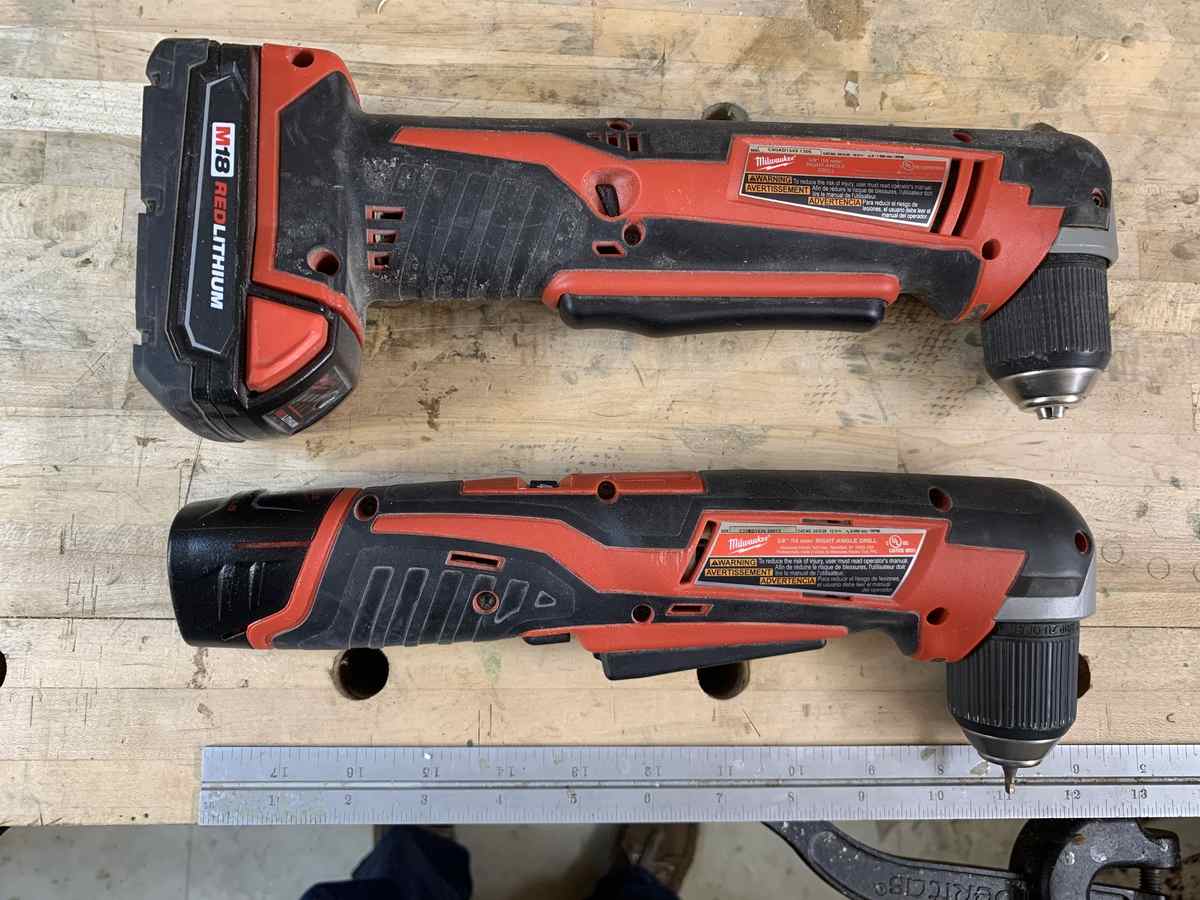

Joe makes a great point. What I find is that, yes there is a weight difference 12 v 18, but there is really a big difference in balance. Here are 2 drills, 12 and 18:
Weight: 3.2lb vs. 2.4lb. Length about the same.
But the 18v feels twice as heavy, due to the larger battery weight away from your grip. Not a deal breaker, but for small things around the house, the 12v excels.
Wiley
