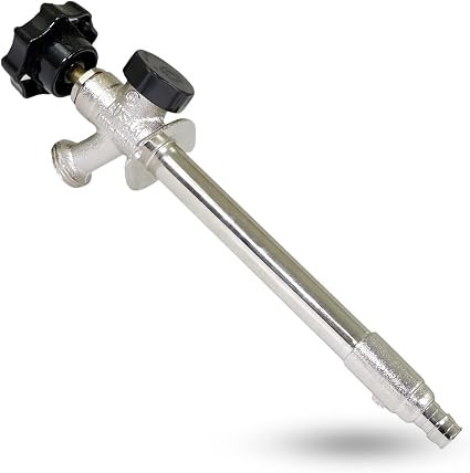

What I did was sweat a ball valve with a hose fitting to a piece of pipe, and then a take off fitting with a pex joint on it. The regular faucets always leak eventually, the ball valve never does. And to boot, we often have specialty hose adapters that mean we just turn the hose on and operate from the special fitting. It also makes it easy to entirely remove the outside fitting for winter. Though while that seemed like a worthwhile thing, I haven't had occasion to do it.
The thread on the back in has the correct aperture for a 1/2" copper pipe. Leave valve open when soldering.
That is an example, the bib I used was a little different.

TomD
I don't, I have never seen such a thing. All the houses I have owned had just pipes going straight outside. I did buy a Pex siphon attachment, It looked great, and was ready to PEX. But there is 8" inches of concrete, and when it would not fit into the hole that was there, for a straight 1/2" pipe as it turned out, I went with the arrangement mentioned. I suppose one could add some kind of backflow preventer. The Pex siphon unit had a regular tap on it, not the ball arrangement I prefer, but probably a ball is available now.
Would a check valve solve my problem? We don't run sprinklers so all I need is enough water to fill some buckets etc...
The product I bought was like this one, though the barrel was a uniform size.
