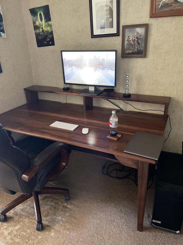

I get your point-This is going to be a desk top for one of those adjustable height contraptions.
My client is the spouse of the person who commissioned my last piece-This work from home computer desk in walnut.

Nice walnut desk.
