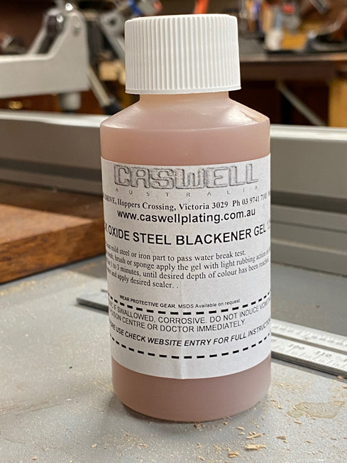

Try this ...
I've been restoring a few Japanese chisels, and this needed to return the steel and iron to black. This is the product I used, purchased locally. It did a great job.
Paint it on. Leave it for 10 minutes. Rinse off. Black.
Re: How to blacken aluminum????
Don't try without more information
Iron oxide and iron phosphate are both black. Any treatment of heat and/or chemical that will make a surface coating of these chemicals on the iron will make it appear black.
The chemistry of aluminum is entirely different. Aluminum oxide and aluminum phosphate are colorless. Any treatment that will make these chemicals on the surface will not result in black aluminum, as was the case with iron. I suspect the product shown either is phosphoric acid or a strong oxidizer that will make the black form of iron oxide.
As far as I know the only way to make aluminum black is to paint it or dye a porous aluminum oxide layer, a process likely beyond the scope of the hobbiest.
Painting aluminum successfully involves some pretreatment of the surface, but I am not knowledgeable of these details.
