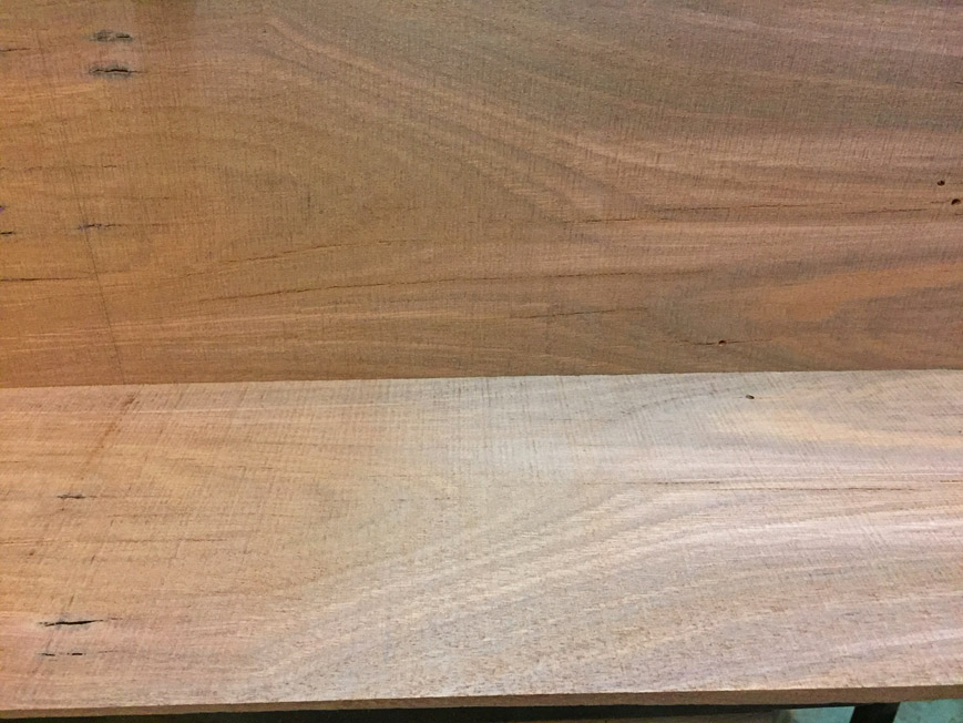

The resaw blade on my bandsaw is a 1" Lenox Woodmaster CT, which is a carbide blade. These are expensive ... however, they are capable of producing a superior performance.
A wide blade has the better potential of a smoother, more consistent cut. However, it is not about the width of the blade alone; the blade needs to be sharp. Bimetal blades are also great, even carbon steel, but there is a wide range in edge retention expected. I've had great results with bimetal 1/2" blades, but when they are freshly sharpened. This level of sharpness is retained by a carbide blade many times longer.
Not all bandsaw can use the carbide blades. It is not simply about tensioning them high enough. That is one factor, but these blades are also thicker (hence higher tension) and they do not bend well. A bandsaw wheel under 16" is likely to cause one to crack. My bandsaw is a Hammer N4400, which is 18" and the frame is built like a tank. Even so, I get only just enough tension. In a smaller bandsaw, one would be better off with a bimetal blade with a thinner cross section.

What blade is best depends on what it will be used for. If sawing expensive wood into veneer a carbide blade makes economic sense. The veneers these blades produce can be used without further surface refining, which is to say, no waste of the expensive wood. However, a blade costing 1/20 the price could prove a better choice for resawing inexpensive wood, or sawing where mechanically damaging the blade is a risk.
Fewer teeth results in faster and possible more accurate sawing. When gullets fill with dust the blade effectively looses set and wanders. Fewer teeth result in a more coarse surface.
No one answer to the question of what is best.
