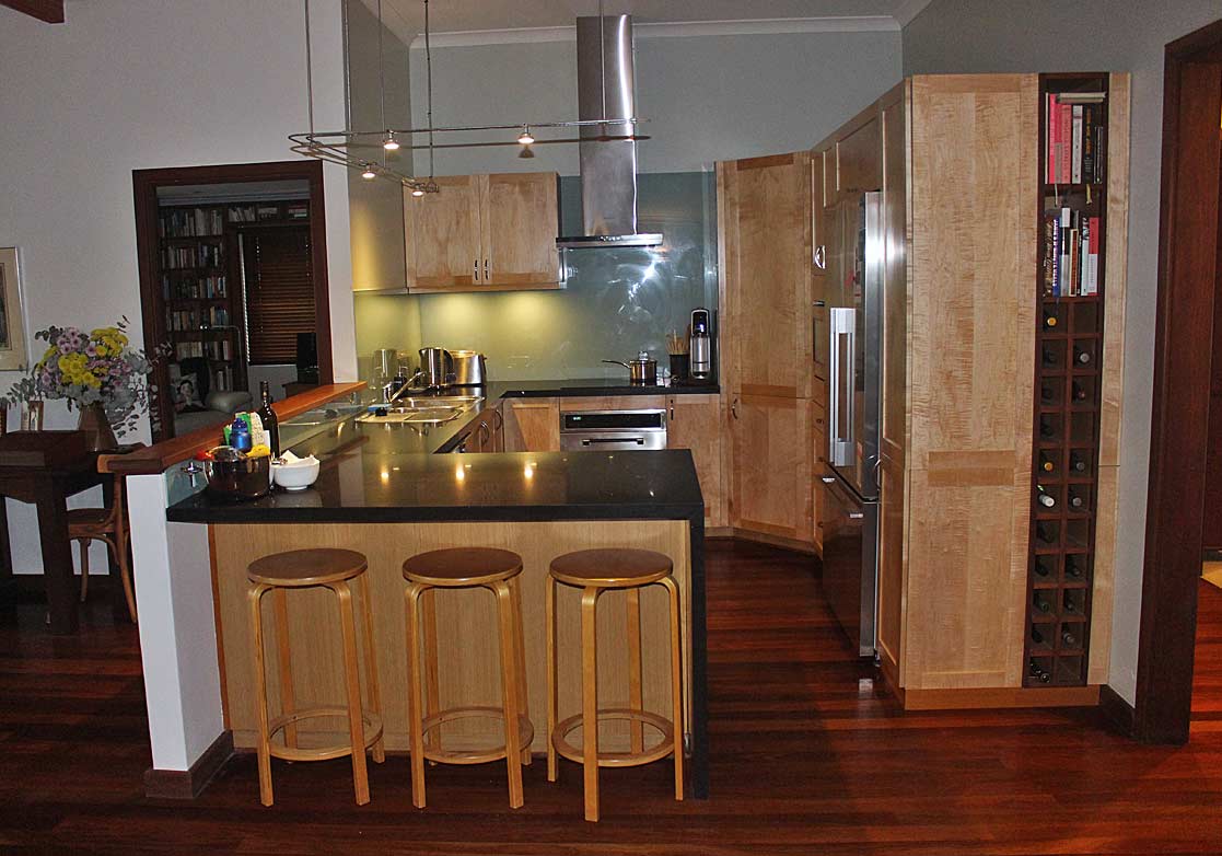

Bill, out of some 20 cabinet doors in our kitchen, which would get steamy in use, 2 showed a widening of one corner where the mortice and tenon was failing (owing to an expansion issue). Deeper grooves sorted this.
Repairs proceeded as above. You would not know repairs happened.
This was the first time I worked with (US) Hard Maple.
The offending doors (situated above a kettle) ..
