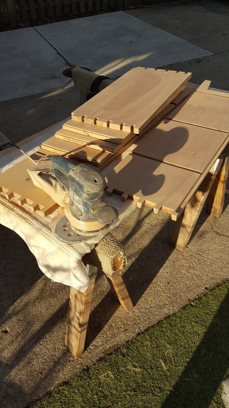

I used my router table
Joe in a Cleveland suburb
and had zero problems. Only took a couple minutes.
Ordered the 1/2" bit on Amazon yesterday afternoon and it showed up early today.
It was so nice out today I was able to take the parts outside and sand them and get ready for glue up tomorrow. I hope to anyway.
Once glued up I'll square up the corners.
I'm sure this would have been ok on the TS but it just didn't feel safe to me. The router bit was worth it.
Thanks.

I worried a bit about tear out.
I used a brand new bit that was presumably sharp and I also put blue tape on all the areas to be routed.
I had zero tear out.
I don't know, but I tend to put tape on edges where I'm afraid I won't get a clean cut or tear out.
When I routed the DT's on the edges of the shelfs, I put tape on and it did gum up the DT bit a little. And I got a fuzzy cut, maybe because it's an old bit and maybe not so sharp anymore. So instead, I wet the edges with mineral spirits to see if that would produce a clean cut and it did.
