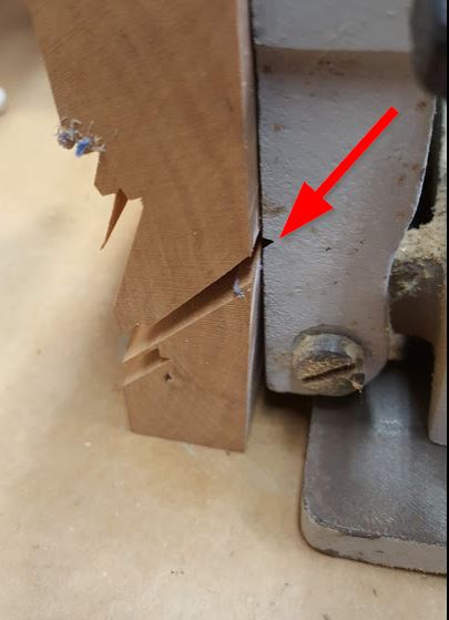

I worked on the flag case a little this past weekend. I managed to make some firewood/kindling and destroy my crosscut saw blade.
The saw blade, a Systimatic I bought around 2000, was damaged by running it into my tenoning jig. Not sure how I managed that. My saw is a left tilt model and the tenoning jig is left of the blade. Which feels really dangerous to me - it's very difficult to see where the cut is going to be and the off-cut gets caught between the jig and the saw blades. I don't plan on using it anymore.
I've had this blade sharpened a couple times over the years and its had some teeth replaced. All the teeth appear damaged and I see two are mostly broken away. Time for a new one. Any suggestions for a new crosscut blade?

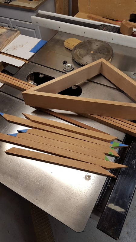

The plan I am using calls for a molding to go on the front of the case that also holds the glass. Each time I try to get good cuts, I keep cutting them short. I think the angle is good (22-1/2 degrees) so I am going to take these pieces, glue them together, and make a ramp to use to sneak up on the cuts for a good fit using a hand plane. If that makes sense.

Ouch. Sorry to hear about your blade. Have you considered attaching a backer piece to the face of your tenon gauge when you are making angled cuts toward the face. You can also flip the board around and angle your tenon cutter. I use my Beall Tilt box to achieve precise angles on mine.
I would replace it with Freud F80 Hyper Finish or a LU73M. Both are excellent blades at a reasonable price.
I would be interested in hearing how you make those really long angled ends on the wider piece of your flag case.

I'm assuming you didn't complete the cut? Looks like it was a bit of a risky cut to me, could have gotten even more exciting than it did.
I once hit a 1/4-20 cap screw head with a router bit - that made an awful noise! I never replaced that screw in the jig after that (it's job was to spread a plastic, split tenon for work holding) as a reminder to tighten the screw when putting a new piece on the jig :D
Can't help much with the chop blade. I bought Diablos for years but the most recent was disappointing - too much clearance angle or too thin a plate, so it cuts like a general purpose blade rather than a chop blade.
Miters can be frustrating, especially such acute ones that take a different set up than you're used to using. Not the same as a 45 where you can cut a bit oversize on a chopsaw and then just sneak up on it. I would probably make a purpose built shooting board for that one and sneak up on it with a hand plane.

I'll look into those. I believe I saw the F80 is thin kerf. Does that matter?
"I would be interested in hearing how you make those really long angled ends on the wider piece of your flag case."
I used the same setup. Worked fine the first time. Not sure why I am struggling with this...

"I'm assuming you didn't complete the cut? "
No I didn't. I quit.
"Looks like it was a bit of a risky cut to me, could have gotten even more exciting than it did."
Right. That's why I quit. Didn't feel safe. Scared me to be honest. And that adds to the risk I think.
"I would probably make a purpose built shooting board for that one and sneak up on it with a hand plane."
That's it. Shooting board. Couldn't think of the term in my original post. :)

Scariest kickback I ever had was the drop from a cut like that, though the drop was outside the piece as I remember. Still don't know what happened exactly, but there were dents in the ceiling and the wall behind the saw. Lucky for me I developed the habit of staying out of the line of the cut as much as I can, so I was standing off to the left.
On that cut, I would expect trouble if the drop got pinched between the blade and the tenon jig, like if it rotated a bit. Yikes! :D
Shooting boards are great. Easy to make, need not be kept if you don't plan to make another flag case. I've made them out of MDF with a brad nailer before, then tossed when done (or 2 years later after tripping over it six times, but close enough to "when done", right? :D )
