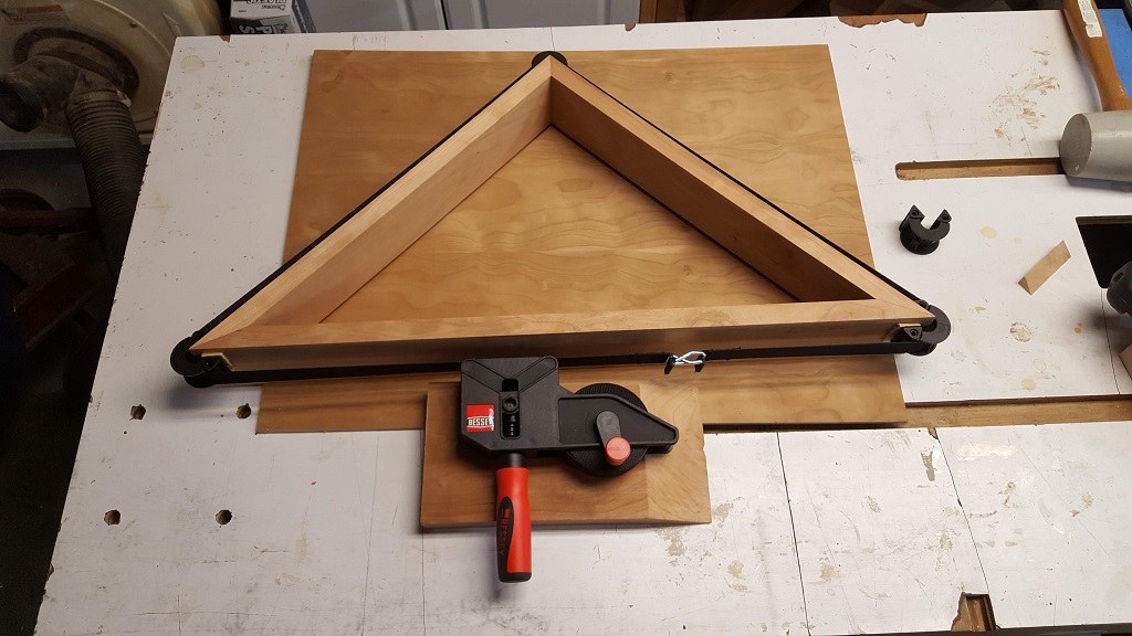

A friend recently asked if I would make a flag case for their grandfather who was a WWII vet. I said of course. So I put my bookcase project to the side to do it.
I'm using mostly scrap pieces of cherry from my bookcase build.
So I quickly made the case as shown below. I plan to glue it to a base with a simple routed detail. The piece of ~1/4" cherry ply will be screwed into a rebate for the back.
Simple question, I've never made anything like this before, should I put splines or something in the mitered corners? I don't think it is necessary, but thought I'd ask because I recall conversations on here about these flag cases.
Oh, and I realized my Delta tenoning jig that I bought in 1999 or 2000 and have used maybe once or twice, is not meant to be used with a table saw where the blade tilts to the left... :b
Thanks.

The joints are largely end grain. An end grain joint can be moderately strong if it is not glue starved. Precoat the end grain, let set a bit to allow all the glue that can penetrate into the end grain, add more glue if necessary and clamp. ("necessary"...either all the glue has penetrated into the end grain or the glue has begun to dry on the surface. I add more glue just in case. )
A spline will strengthen the joint but only come into play if the case was dropped. Or could be added as a decorative element, not something I would do.

The bottom joints have a lot of glueing area so they are good. The top, back will be reinforced by the glued on back so it is OK. The only weak spot that I see is the top, front, miter. I would reinforce it with 1 or 2 small brads tapped under the surface and then filled.

I have made several of these. I don't reinforce the corners because the case, once the flag is installed, is not likely to be opened again and because the plywood back is screwed to the sides and bottom.
When I make one for somebody, I leave the back off (but pre-drilled for the screws) and send it with screws and a screwdriver of the correct size. Most people do not have a screwdriver for screws that small.

I've made a number of flag cases for friends and relatives. I glue the top joint without any reinforcement. I apply glue to both sides of the joint to prevent glue starvation. I believe that doing this makes a much stronger miter joint than applying glue only to one side. It allows both sides of the joint to suck in some glue before the glue starts setting up.

I make 3 or 4 of them a year. I do spline mine generally with contrasting wood. Doesn't take that much more effort, adds to the appearance, and ensures the corners won't open up at the wrong moment.
Just a couple table saw blade width splines are all ya need.

I use splines on the flag cases I’ve made. My friends and customers have not complained.
