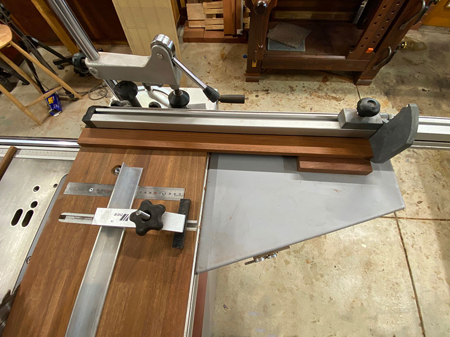

Measuring the drawer blades had been done. First, a pinch stick obtains the width from inside the dado, and then a template is made with scrap ...
Set the template on the slider ...
... and cut to size the front- and rear rails ...

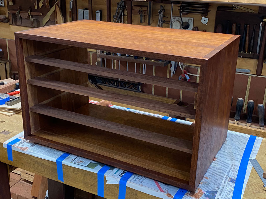

Returning today, I thought that it wouldn't hurt to stain the Merbau case to match the Jarrah rails and drawer fronts. By the way, Merbau is also known as Kwila.
As mentioned at the start, the reason for choosing Merbau for this cabinet was simply that it was cheap and already available as a panel. This came with a cost, in that it is not the nicest wood to work with - interlocked and coarse grained. Plus, of course, it is light in colour. The result needs to blend with the Jarrah bench.

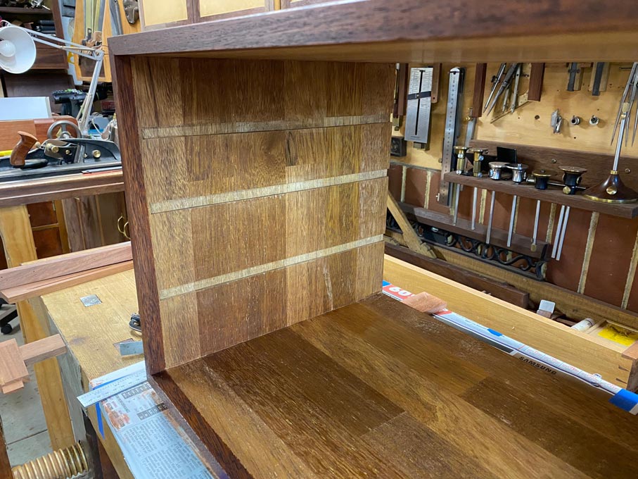

The first step was to use a grain filler on the outside and inside of the case. The surfaces had already been sanded to 240 grit.
The first two coats of the stain were initially mixed with a little methylated spirit, and the concentration increased for two further coats ...
