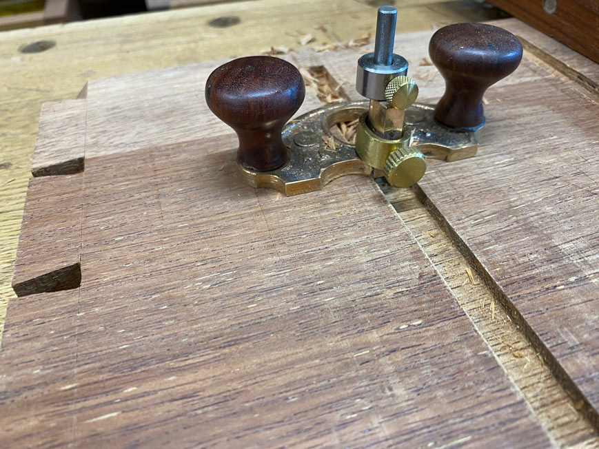

The router plane's depth stop is set to 5mm, and this is reached incrementally ...
The final 1mm cut (to a depth of 6mm) is made by a smaller router plane ..
The reason for this is that, as with a smoother, which follows the undulations of a panel and removes the least about of material, so this small router plane will create an even depth.

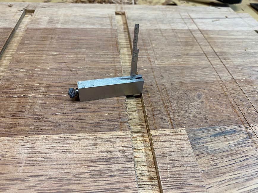

The depth is checked ...

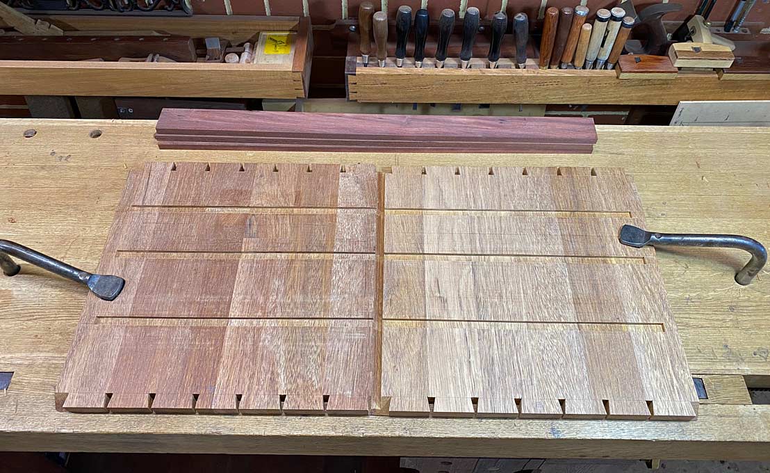

Once done ...
... the surfaces are sanded to 240 grit. This is an original (!) Festool sander, when it was still "Festo"! I have had this about 25 years. Heavy, but works well for this task.
A final test for the accuracy is to align the sides ...
... and then run a drawer blade across both dados ...
Time to glue up :)
