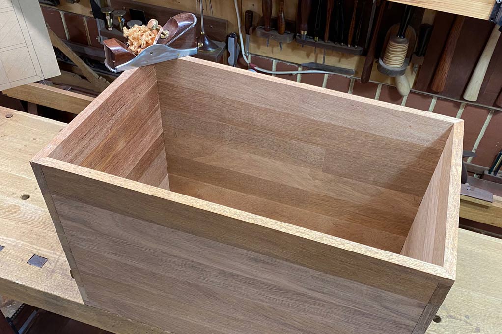

The first step is to level and square the front and back edges of the case. My plane of choice here is a small bevel up plane with a high cutting angle. It is low like a block plane for easy handling, which is helpful when the case is high on the bench ...
The case is 18mm (3/4") thick. The rebate will be 7mm deep x 12mm wide. This will allow for a 6mm thick rear panel.

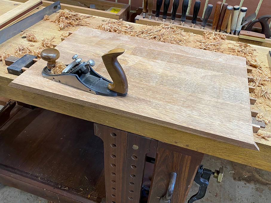

The cabinet will have four rows of drawers, with the lowermost row running on the bottom of the case. It is important that this surface is perfectly flat in order that the drawers run smoothly. The boards making up the sides were flat out of the packaging. Certainly flat enough for a case, but not quite flat enough for drawers to run on with the level of precision desired here. They need further work ...
The case is pulled apart, and the lower panel is traversed. Note that the surface is first covered in pencil scribble to monitor where the high- and low points are ...

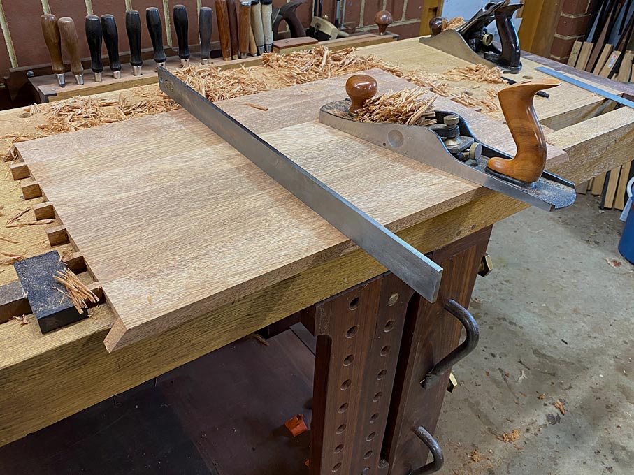

A straight edge and a longer plane are used here ...
The blade here is slightly cambered to avoid leaving track lines. A very light surfacing is completed with a smoother, more to remove any fuzz than to level ...

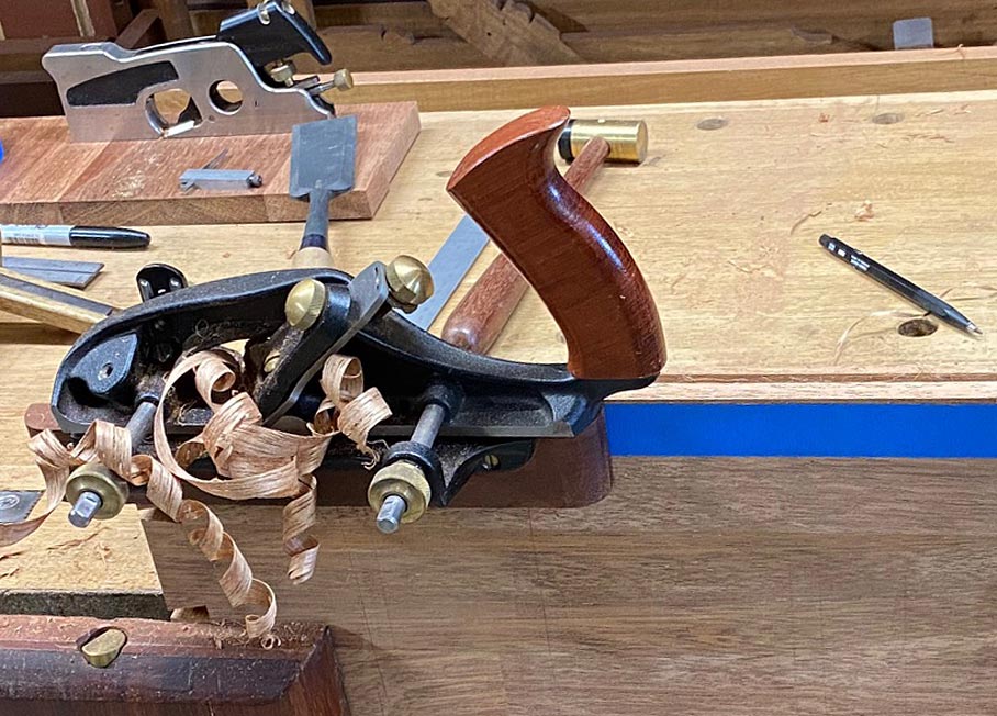

The moving fillister of choice is the Veritas Skew Rabbet Plane ...
Those familiar with this plane will note that the front knob has been removed. My preference is to rest my thumb on that spot and apply downforce, while the palm applies force against the side of the plane. Here is an example from another build ...
This fillister has a deeper subfence. The depth stop knob has also been slotted for ensure that it has been tightened securely ...
The plane is generally only set up to slice with the knicker ahead of the blade when planing across the grain. However, the Merbau used here has especially interlocked grain, and the nicker it employed to prevent spelching on the shoulders.
Here, the nicker is a smidgeon outside the body of the plane. The skewed blade lies in-line with the nicker. This has another purpose, which is to cut into the lower corner of the rebate and keep it clean and square. Otherwise it would allow waste to build there, and the inside would create a slope.
In addition to the line created by the nicker, a cutting gauge is run along the rebate boundary. This may be used after or during the rebate is cut to clean out the inside corner.
One last item of preparation is, following marking out the rebate (again with a cutting gauge), the lower boundary line is highlighted with blue painter's tape. This is simply to aid in monitoring the plane as it gets close to the line.

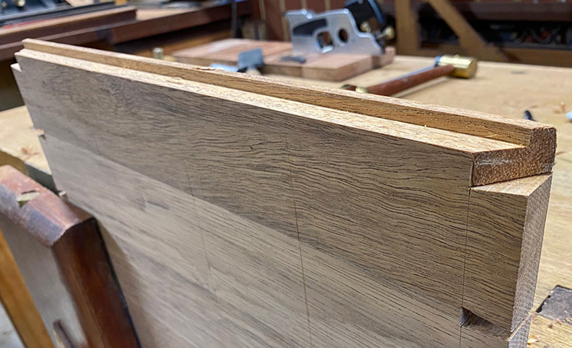

This is what the shavings from fairly straight-grained wood looks like ...
This is the result when the grain is significantly interlocked ...

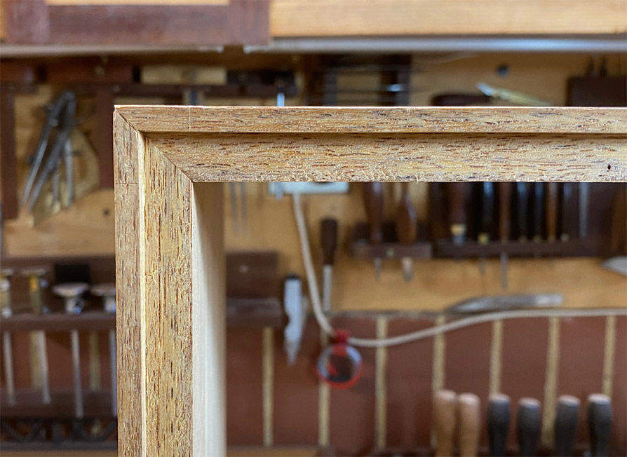

The case is dovetailed with mitres at each corner. There are two benefits for this: the first is aesthetic; the second is that it permits the panels to be rebated through the full length (otherwise stopped rebates are needed) ...
Here is a better glimpse of the grain direction ...

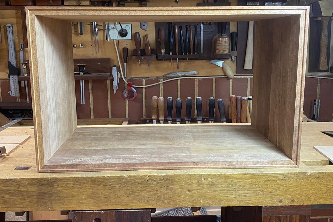

The case back is done ...
The finish we were looking for ...
