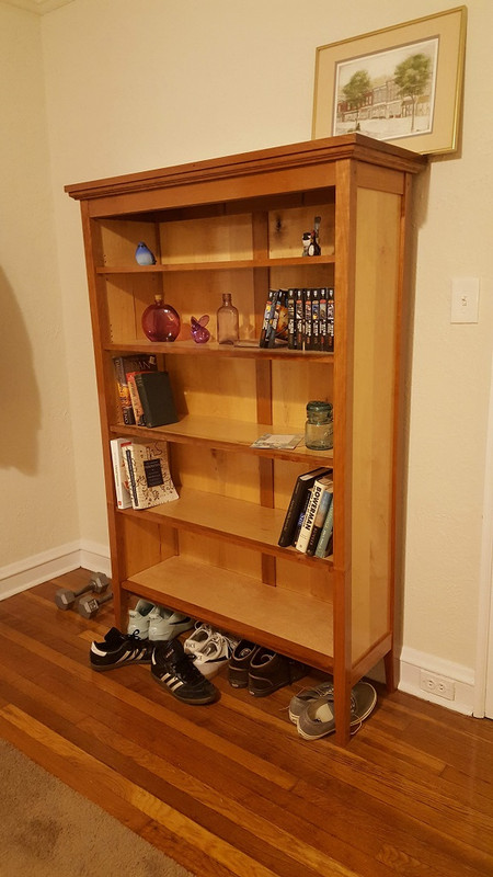

Here is the last bookcase I made a year or two ago for my son. Cherry and maple.

Wow super nice. Especially that second one. Beautiful.

Hi Joe, I made Chris's bookcase and used his dimensions. I regret not adding some height to two of the shelves as they don't accept some of the larger books.
