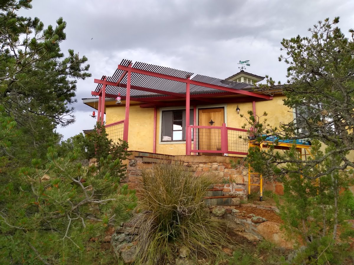

I've almost finished the one we started early this summer. Just need a bit more railing and a hand rail for the stairs:
This faces almost due west. At the height of the summer the setting sun is a little north of west, we were careful to orient the shade slats so that they would provide maximum shade during the summer as the sun sets. Cloudy this afternoon, so you can't see the effect.
