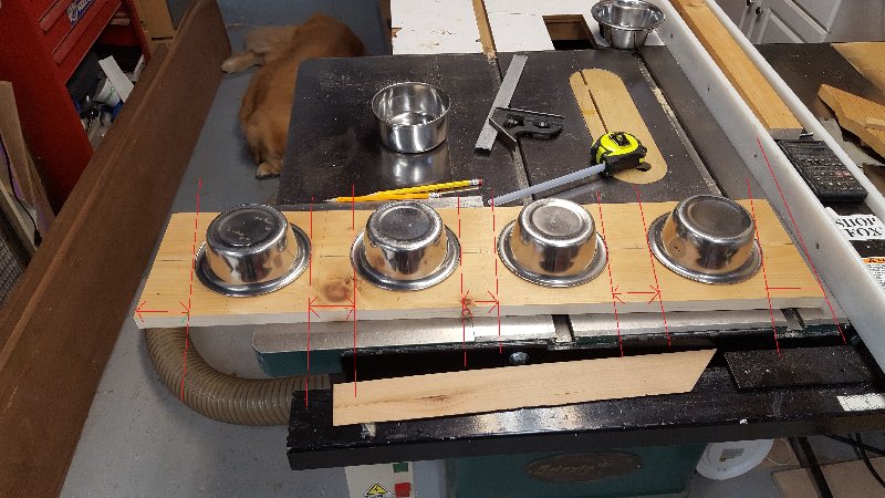

I have a board that is 31-3/8 long. I need to put holes in the board for 4 bowls. The bowls are 5-1/2 diameter.
I need equal distance between each bowl and the edges of the board.
What should the measurement be between the center of each hole?
Or, how do I calculate that?
Thank you.

Mark line a for each bowl section at 7-13/16" intervals. The center of each section will be 3.91" or about 3-31/32. Using that as a center point for your holes you'll be about 1/100th of an inch off dead center. Ain't mil-spec but close enough for govment work.

(30 3/8 - (5 1/2 * 4)) / 5 = 67/40 = 1 27/40 = 1.675
Each of the spaces between bowls and at the ends is 1.675".
The center of the first bowl from the edge is 1.675 + (5 1/2 / 2) = 4.425".
The center of each succeeding bowl is 5 1/2 + 1.675 = 7.175"
So center of second bowl is at 11.6" from edge.
Third bowl is at 18.775 from edge.
Fourth bowl is at 25.95 from edge.
I think that's right but somebody check my math.

Your board is 31 3/8 inches long. multiply the dia. of the bowls by 4. This gives you 22 inches. Subtract from 31 3/8 inches and you get 9 3/8 inches. Divide by 5 and you get 1 7/8 inches. Add 1/2 bowl(2 3/4 inches) dia. to this number and you get 4 5/8 inches. Measure from both ends and mark. Add one bowl dia. and 1 7/8 from your first two marks and you have the location of your second and third holes. Hope this helps.

Close but no cigar ;) -- you started out with the wrong overall length of the board. I used an almost-identical method (which is perfectly sound) and find the space will come out to 1.88" I didn't bother to convert to fraction so that is left as an exercise. (OK so it would be 1" + between 56 and 57 64ths.)
If I was doing it I thing I'd just find a nice round number and, if possible, cut the board a hair shorter to make it work out painlessly. Anyway, It is doubtful that anybody will be coming by later with their digital calipers to check the work.

I agree with Joe, mark your board 4-5/8 from each end, then 9-1/4 from each of the 4-5/8 marks.

The math has been covered ad nauseum above, however, I think the spacing is a bit off. When spacing items like that along a length, sometimes it looks better for the end spacing to be half that of the spaces between items. So instead of dividing (board length minus sum of bowl diameters) by 5, divide it by 4 to get the between-bowl spacing, then halve that number to get the space at each end.

I agree. I would use the same "two pair of dividers" method that works so well for laying out hand cut dovetails. Of course, for this exercise, you would also like to have a third compass set to the radius of the dog bowls so you cn get a feel for what the layout it will look like when finished. No math and no rule necessary.

I know Joe didn't ask about this, but when there's a little odd bit leftover, I make the center space wider by that much. Everything still looks balanced, and as you pointed out, (almost) no one will measure and make a fuss.
