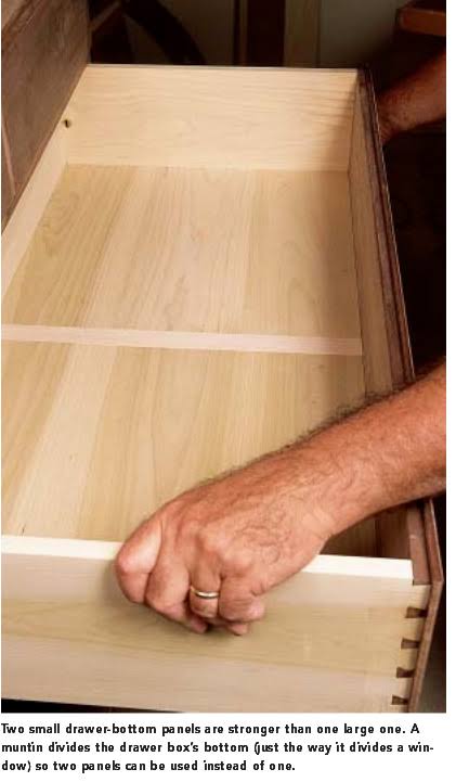

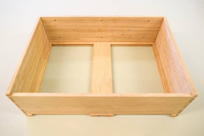

JL, when drawers are this wide (greater than 20” in my book), then the drawer bottom needs to be supported. Adding thickness is poor design - it may add stiffness but it also adds weight.
The appropriate design for a wide drawer is to add a muntin through the centre. That is, a reinforcing stretcher. You can then use two 1/4” thick drawer bottom panels on each side.
Lots of designs. This is off the web, and it uses a slip all around. I might use slips at the side, but just a groove behind the front, and secured to the back with screws.
This is more typical ...
Re: Drawer bottom thickness?

Re: Muntin
Joe shelton
Whoever did that muntin in the second picture did a very nice job.
