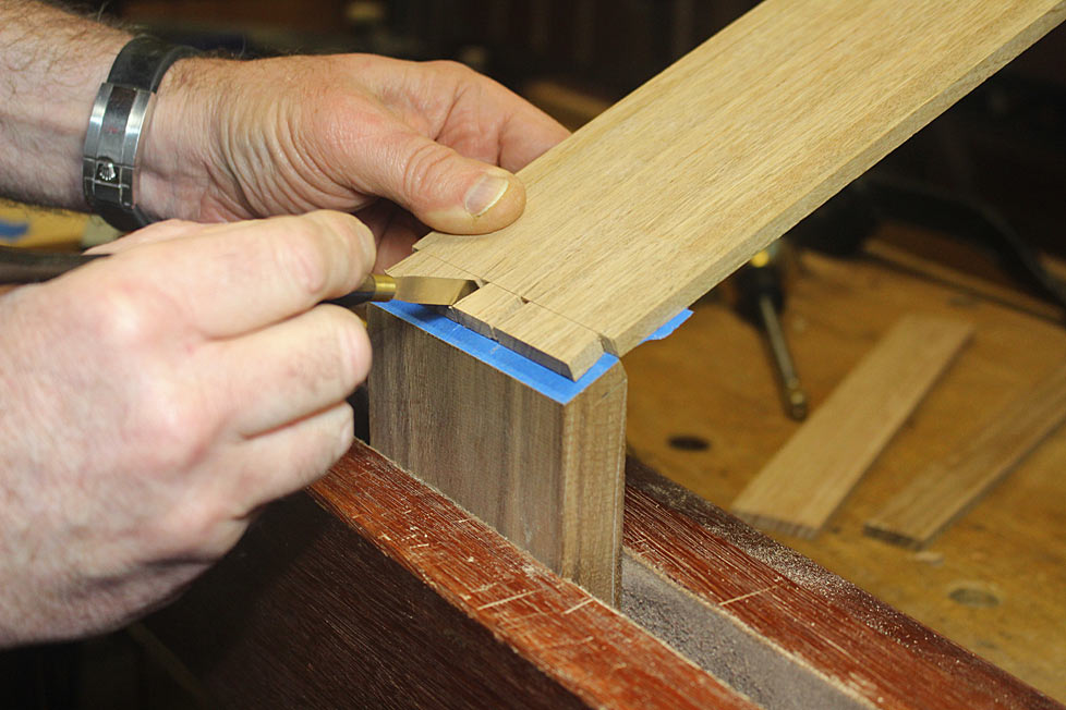

I've build a lot of drawers like this over the past few years. Transferring tails to pins looks like this ...
Aligning the side is aided with a simple, deep wooden square (I use this for square ends as well) ..
Another way to align ends is with blue tape ....
http://www.inthewoodshop.com/Furniture/The140TrickisDead.html
