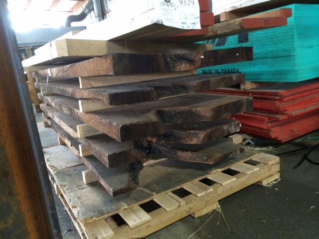

I have some huge red oak slabs (3' by 9' by 2.5" average, about 36 of them) that have been sitting in a shed, stacked and stickered for 6 months.
Is red oak hard to dry? What's the next step? How long do I wait? Does this require a highly experienced kiln operator? How about a vacuum radio frequency kiln?

Hi Barry - If things are going well and you're not under a time crunch, I'd continue to let them air dry. While red oak is easier to dry than white oak, the size of those slab would have me concerned about possible honeycomb. If you must kiln dry I'd definitely find someone with experience drying oak of that size.
I while back we air-dried some 3" x 20" x 60" Hawaiian Koa slabs for a few years and they acclimated nicely. Took forever but came out nice.
Good luck.

As I remember it, the rule of thumb for drying is 1 year per inch of thickness. I've heard of people wrapping the bundle with plastic and using a humidifier to speed things up.

Hopefully you will get more gentle responses than I did a year ago mentioning that guideline. But in all honesty, the environmental conditions in which the wood is stacked and stored greatly affect how quickly moisture moves out of the wood. And yes, the best guideline is to measure regularly with a moisture meter.
The freshly cut green black cherry we air dried here in Cincinnati, 4/4 and 8/4, was covered, stickered, open on the sides, and off the ground. The wood was sawn and stacked I think in March of last year. By November, the 4/4 was reading about 10-12% moisture content and the 8/4 12-14%. I was comfortable at that point moving the wood in my concrete block woodworking studio, which is heated to 60 at night and 66 during the day, again stacked and stickered. It will become furniture in a residence, so I won't begin to mill it until the moisture content becomes stable.

Don, thank you for the response. I too have dried cherry and walnut in an open shed. It was 4/4 mostly and I started using it after about a year and have been using it ever since. I bring the stuff I am about to use into a conditioned room in my house and start to do stock prep on it as it acclimates. I think the slow pace I move at is beneficial, giving it time between functions to continue adjusting. I try to use good technique in whatever I build to allow for seasonal movement and I have never had a failure that I am aware of.
Unfortunately, these slabs are too big and heavy to shuffle around casually. I have not actually weighed one, but my calculations indicate they weigh 250 pounds or more. And at 4' by 9', well I just don't want to end up under one. On top of that, I visited them the other day and the owner of the building/shed they are in has surround them with his collection of rag tag race cars to the point you almost can't walk up to them.
At my age, I want to get on with it.
