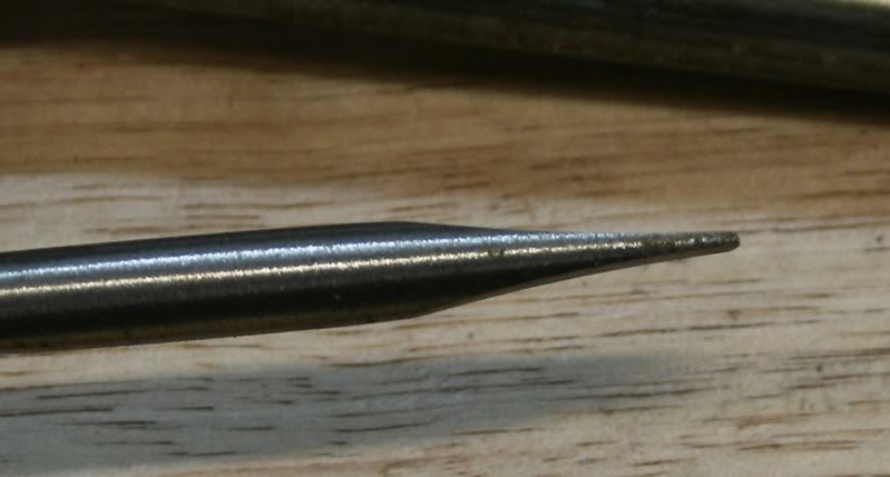

I am using a Grace #6 driver. This project has 10 hinges, 60 screws. This perfect fitting bit never lost grip. But the square handles suck. I turned them round with the lathe.
I wish someone would make a suitable screw driver for brass hinge screws. It needs parallel ground tip. and a round ergonomic handle. It does not need to deliver 100 ft pounds of torque; these are brass screws!

Bill, I have 2 different sets of Gun Smith screwdrivers. They have various width and thickness of insert blades and can be ground to perfectly fit any screw. I have used them on some woodworking projects.
Amazon carries them: https://www.amazon.com/s?k=gunsmith+screwdriver+set&crid=1I5OOBRBQ1X94&sprefix=gunsmith+%2Caps%2C189&ref=nb_sb_ss_i_5_9

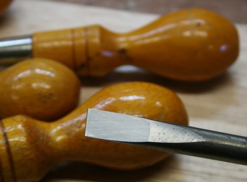

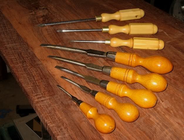

Bill, I have a set of old Marples flat head screwdrivers. These are supplemented with Philips heads I made up from handles at Lee Valley.
The Marples are a classic design, with slightly oval heads.
I modified the heads by hollow grinding on the bench grinder ...
