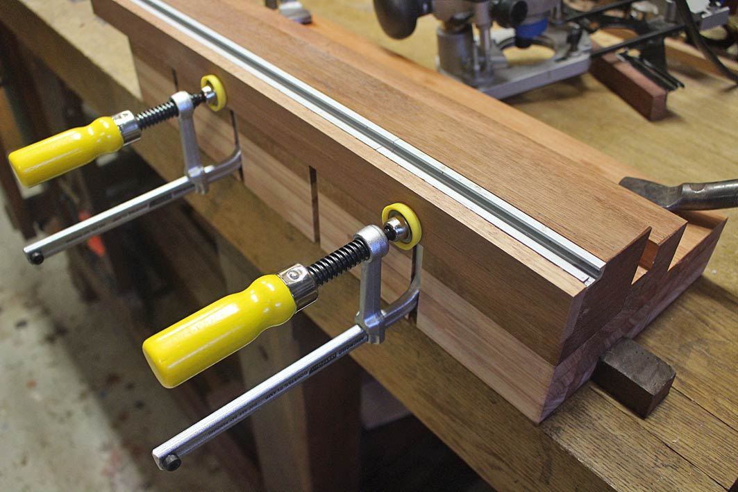

Now we come to the new jig. I must tell you that this did my head in for a long time. As with everything, there is a simple solution, and in the end it could not have been simpler!
The need is (1) quick and easy set up, (2) accurate routing leaving minimal waste, and (3) visibility and dust control (bloody machines!).
The jig
This turned out to be nothing more than a block of wood. This one is 16"/440mm long x 4"/100mm high and 2"/50mm wide.
I used MicroJig clamps, which slide along a sliding dovetail. This is not necessary; one can just use a couple of F-clamps. However the MicroJig clamps not only make work holding less finicky, but they extend the length of the board one can hold with this particular jig to 500mm. That is easily enough for most case widths.
To use, place face down on a flat surface and clamp the drawer front close to centre ...
Up end the combination, and place the end of the drawer front into your vise. This could be a face vise or, as here, a Moxon vise. Note that the image is taken from the rear of the vise ...
This is what you will see when standing in front of the jig/vise ...

Setting up
Step 1: set the depth of cut - I scribed marks on the fence for two drawer side thickness I use. Mostly I use 6mm (or 1/4"). The other is 10mm, which is used here. I shall make another, deeper fence, so that I can add a few other thicknesses, such as 19mm for case sides.
Step 2: set the cut to the boundary line - this is done as close as possible. In the end I want to leave about 1mm to clear with a chisel (this is such an important line that I am not willing to take a risk here). If you move the bit side-to-side, the scratch pattern will show where it is cutting ...
The result
The router bit is 5/32" carbide. It is very controllable, and this makes it possible to freehand close to the side kerfs. The fence/depth stop prevents over-cutting the boundary line. In 15 seconds, this is the result ...
