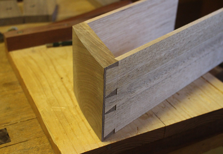

Well it can be done. 4th try. 3rd try would have been a success but I cut the pin angle backwards. Heck, I've done that on 90 degree dovetails so I knew I was on the right track :)
I cut pins first. It led to marking problems which led to saw cuts in the neighborhood of where they needed to be. Will try tails first next, or I need to come up with a way of registration off the pointy end to mark the vertical saw cut lines. Knowing it can be done I shall press on refining the appearance. This try would hold the drawer together and that is what it is all about for me. On this point I differ with some.
This joint is wicked strong due to long engaging surface. As sloppy as this joint is I can't wiggle it once dry fit together. Assembly will be an issue. There is no orthogonal surface to bash on to force the joint together by bashing.

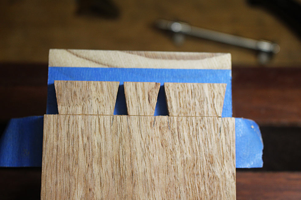

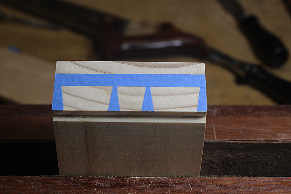

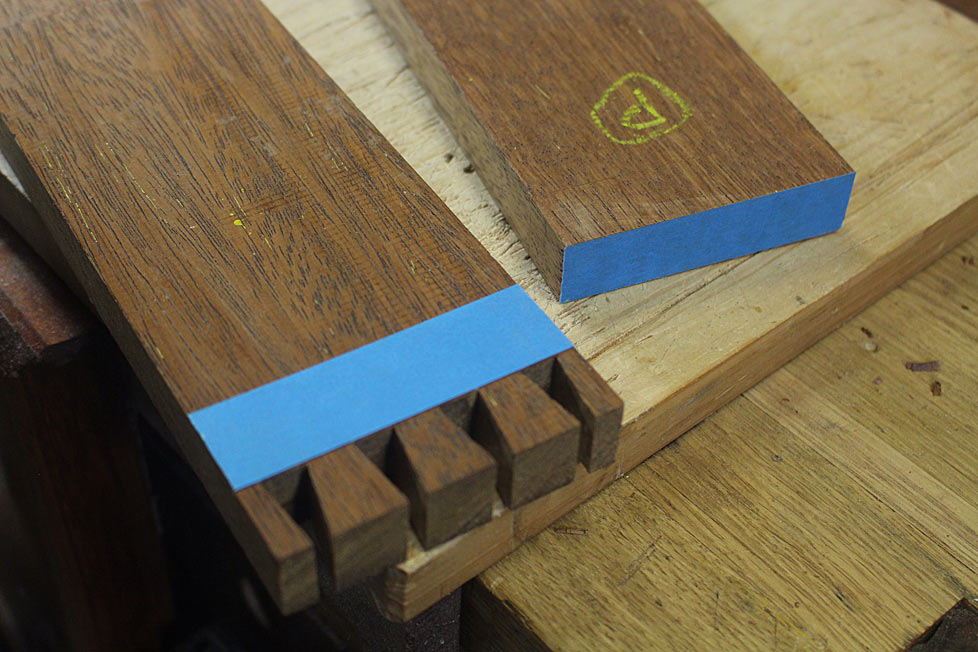

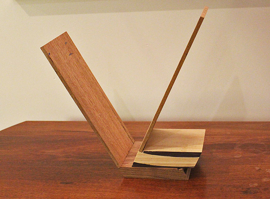

Bill, you may recall that I have made quite a few drawers with compound angles. I came up with a method of registering boards to transfer tail to pins that uses blue tape in place of the rebate recommended by some.
I use 3 or 4 layers of tape, applied just over the baseline, than slice then to the baseline with the cutting gauge ...
If you use blue tape also to mark off the transfer, it becomes easier to see where you must saw ...
Some of the angles created ...
