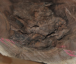

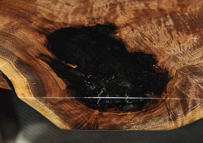

Hi Alan,
I use several kinds of epoxy as I work with "character" wood a lot. For anything over 1/8" and less than 1/2" thick I use System 3 general purpose resin with "fast" catalyst; thicker pours n3eed slower catalyst to control the reaction heat. I measure by weight [100/44] per Sys-3 directions. For small cracks, checks, and such, I use thinner resin and slower catalyst ("Mirror Coat" or equivalent) to get better penetration. Depending on the application, I can color the resin with epoxy pigment (black or white) or use Trans-Tint dyes to tint the mix. I also use wood flour to thicken the mix for paste applications.
Small tip: Before applying your filler, do two things:
1. Check to see if you need to seal the opposite face of the wood to prevent leakage. Masking tape doesn't hold well, but a quick brush with Anchorseal (wax emulsion) covered with a piece of plastic wrap does well and removes easily.
2. Also give the surface around your "repair" a quick swipe or two with a paper towel and dewaxed shellac to prevent the epoxy from staining the surrounding wood. Cleans off nicely with sanding.
Re: Filling knot holes with epoxy or other
Example
Before:
After:
This was done in two pours; the first to about 1/4" and the second 3/4" to fill the 1" deep cavity using clear resin and medium catalyst to give the mix-air time to migrate to the surface. Sanded to 320 and finished with waterborne acrylic lacquer.
