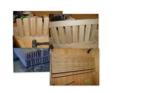

Frank Mutchler
>Bill, I use the RouterBoss. Prior to that, I used the WoodRat and prior to that I used a ShopFox bench mortiser and table saw tenon jig. I only use the RouterBoss now.
With the RouterBoss, it's possible to make one setup and cut both the mortise & tenon or cut each with its own setup. Quick and painless either way. The pic shows some of the m&t I cut for a Stickley Encyclopedia table.

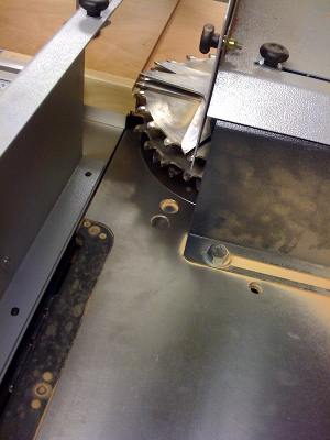

Phil in NJ
>Hi,
Just completed my first major project doing M&T using the sliding table shaper and dado blades for the tenons, and the horizontal mortiser.
Attached a picture of the tenon setup on my Felder saw/shaper with sliding table. The dado blades are stacked with the "outer" blades separated by the desired tenon width, with the chipper blades above and below. This operation is cutting a 7/8" thick , 3-1/2" long tenon on 1-1/2" stock in a single pass.
The approach works well, fitting the tenons to the mortises.
-Phil

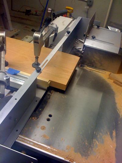

Phil in NJ
>completing the tenon cut.
