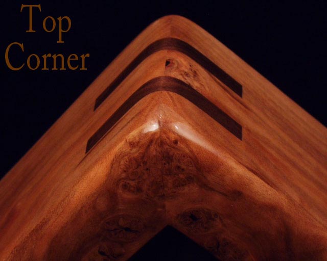

>I fill my knot "holes" and defects all the time with blacken epoxy, the 5 minute Devcon stuff in the syringe tubes and blacken sanding dust, see pic below. I take some fine sanding dust from, walnut, oak or cherry, has tannic acid in the wood. Add some iron filings to the dust, grind an iron nail if need be add water and mix. Set a side to dry out. Use a magnet when stuff is dry, add the blacken power to the epoxy mix and fill void slightly proud. When dry, file/scrape sand flush and enjoy your work. You are not hiding the void, but rather accenting the defect. It looks like a natural smooth and level mineral area in the wood that makes a negative into a positive.
I get quit a few comments on my wood's organic look. One of the plus sides, the blacken filler is free. I've made less than a half dozen batches in my 12 years or so of figuring this concoction out. I does not take much filler in the epoxy mix.
