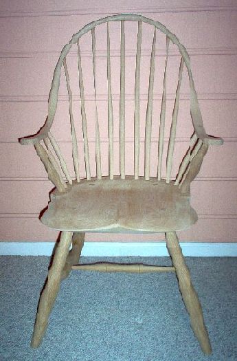

Below is an example of one of my chairs - excuse the poor picture.
