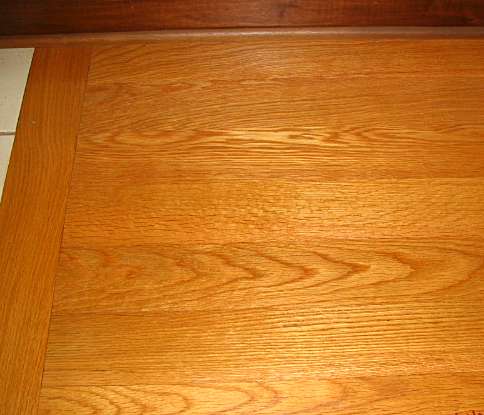

Tim in SE Michigan
>I think Tim is talking about flooring that looks something like in the attached picture. I would agree that this just looks awful. A true hand scraped floor like Bill is talking about is a beautiful thing.
