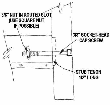

Here's one way...
>Depending on the post/rail design, you can use K-V or Hafele countertop connectors instead of the bolt, but this is a little easier to do.

Thanks Ellis....
Mike Fitterling
>. . . but I think Barry had an arrangement that had no bolt or bolt head exposed on the outside of the leg IIRC.
